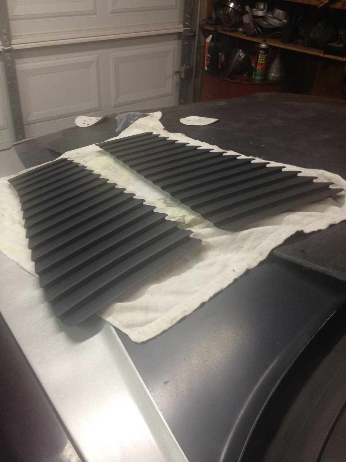

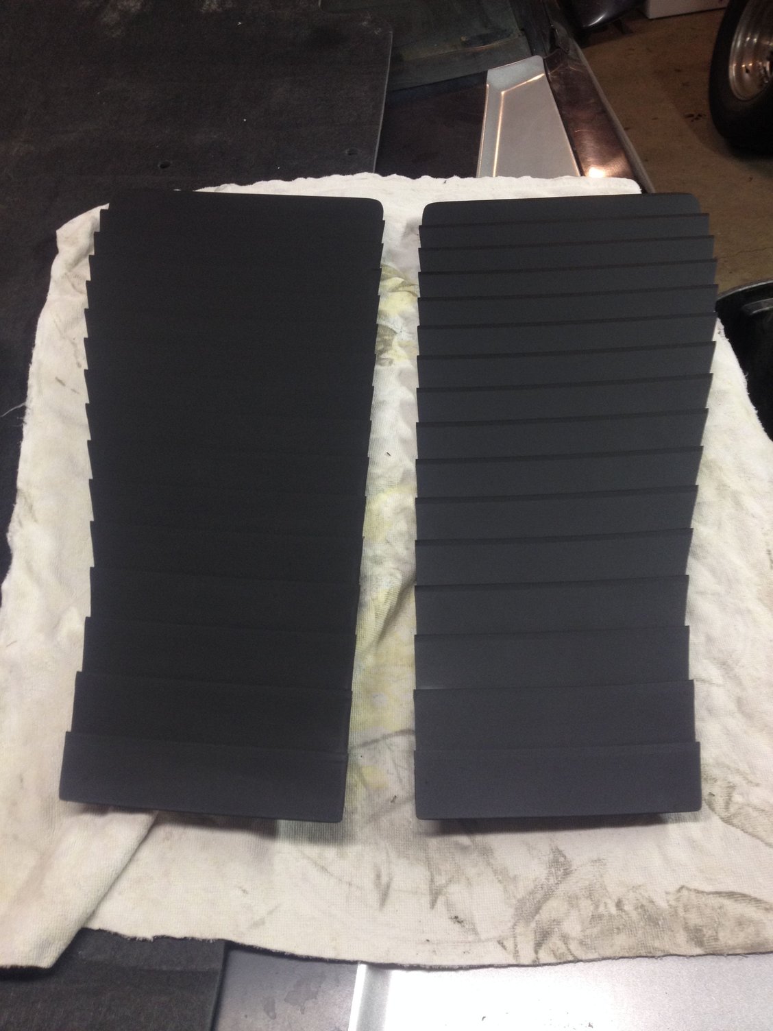

my $100.00 score. They came with a good hood that is at the body shop getting a little paint.
