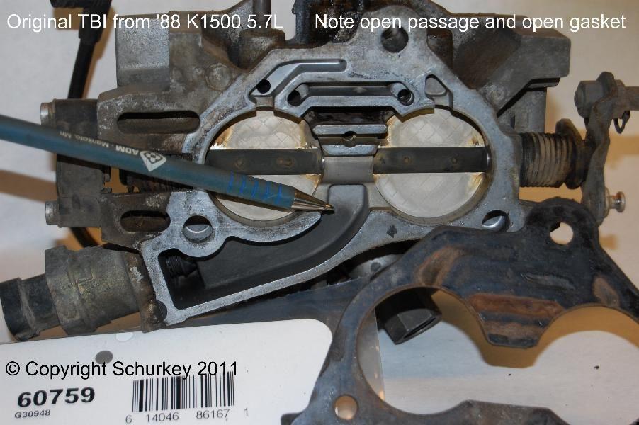

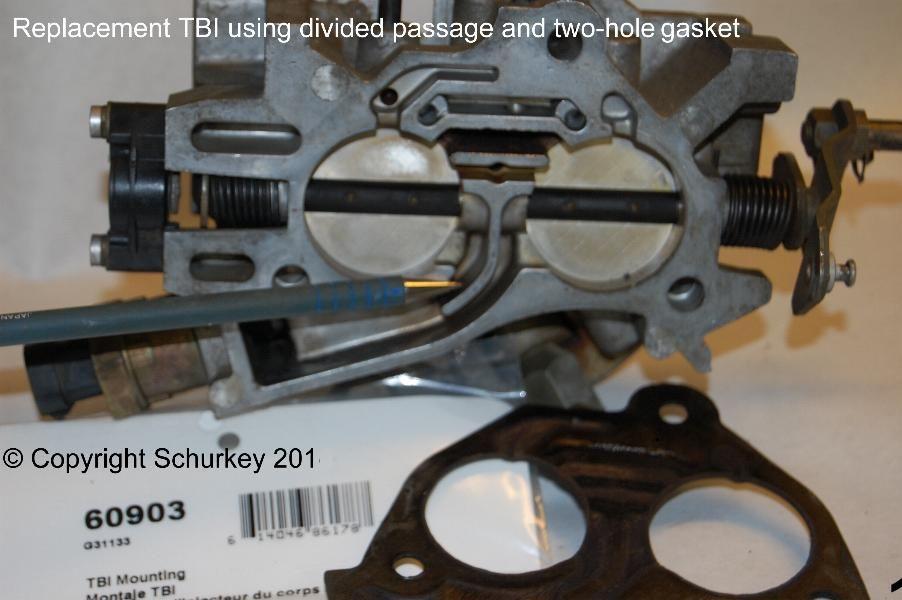

No idea on Camaro TBI, but here's photos of my original '88 TBI compared to a later-model unit I installed on a K1500 pickup.

They're all the same unit except the TPS as 84redta said. I think around 90-91 they changed to the weather pack connector. Also the truck and car throttle bodies differ with their throttle linkage, be wary.
