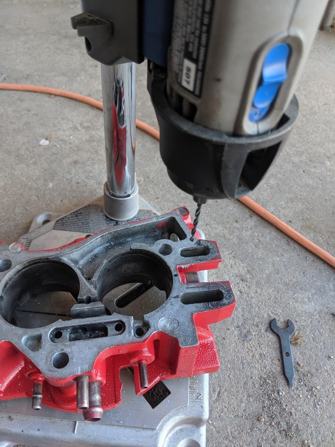

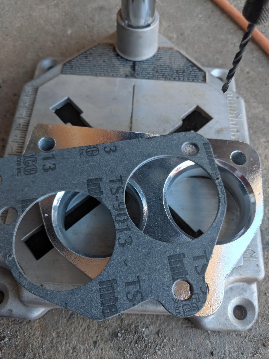

Can anybody help me with modifying the TBI for boost? I've read you need to pressurize the throttle shaft by drilling holes through where the throttle shaft rides, and attach a vacuum/boost line to where the holes are drilled. I'm a little unsure where to drill the holes however and would like some guidance or pictures if anyone has any.
Do I drill holes from the top/bottom to get reference (like picture 1, and if so, at the red circle, or orange circle, or all 3?)
Or, do I drill holes through the sides (like picture 2?)
Or do i drill them somewhere else? I can't seem to find a picture reference of someone who has done it, so I don't want to start on this until I know for sure where to drill. I did manage to find a 454 TBI at the local junkyard after purchasing one on ebay for over 200, so if I do mess this one up I have access to another one for about 40 bucks, but I'd rather not mess it up!

Old Oct 12, 2019 | 08:21 AM
RBob's Avatar
Posts: 18,432
Likes: 234
From: Chasing Electrons
Car: check
Engine: check
Transmission: check
Re: Turbo and TBI
Here is how Joby did it:
http://www.joby.se/corvette/mods/2001-0X01_tbi_mod
Note that is a crossfire hence the 1-bbl TBI units.
A different method:
It is best to get the pressurized air prior to the injector flow. This will prevent fuel from being blown out past the shafts.
RBob.

Hey thanks RBob, you've been super helpful over the years and your EBL system has been awesome for my car!
So just to make sure I'm getting this right, I should drill holes on the outside of the TBI unit to the throttle shaft, probably JB weld in some small vacuum nipples, then route those hoses to the intake tubing before the injectors?
Here is a crude drawing of how I understand it to be:
I'd want to drill on the outside of both sides of the TBI unit, so I'd have two vacuum lines going somewhere to the intake piping before the injectors correct?

Thinking about this and looking at a TBI unit. See your picture above of the bottom of the TBI. Drill holes where the orange circles are, no need for the center support to be drilled.
Then drill matching holes and feeds into the intake manifold to TBI unit adapter plate. This way the pressurized air can be fed into the adapter plate and on to the TBI shaft locations. As for getting the pressurized air, any place after the turbo and prior to the injectors works.

I didn't even think of that, that's a good idea! Currently, I have the Edelbrock vortec to carb intake manifold and there's a chance the intake ports may be too big and not match up correctly. I'm using a carb to TBI adapter on the manifold (which I'll have to bore out bigger holes to fit the 454 TBI unit.) The adapter plate is probably too small for holes from the side as well because it's only about 1/4" thick. However, I do have a spacer I had to take off (since it wouldn't fit with the new manifold) that will probably fit with the carb hat. If it does fit, I'll just drill holes in that!

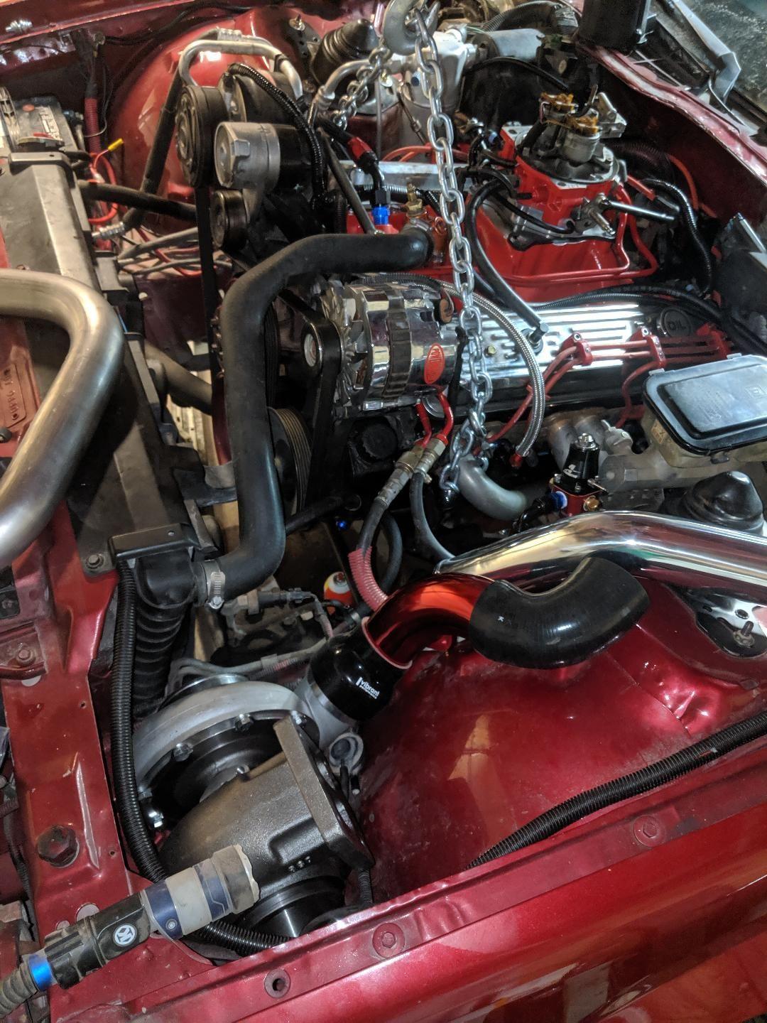

It's been a little while but I have made some more progress.
I managed to get the 454 TBI all back together with the 80lb injectors and drilled for boost reference. I had to purchased a 454 TBI spacer so I could route the vacuum/boost reference lines through that due to my edelbrock vortec intake not lining up properly to drill boost lines down. I still need to attach different electrical connectors for the TPS and IAC valve, but that shouldn't be too hard. I have the connectors, I just have to get the proper wiring before connecting everything.
I ended up gorilla glueing some vacuum lines into holes I drilled on the side of the spacer since I don't have a good way to weld aluminum. I tried using JB water weld (since it's what I had on hand), but I think I messed with it too soon and broke the connectors off. The gorrila glue seems to be holding up decently though so it should do the trick.

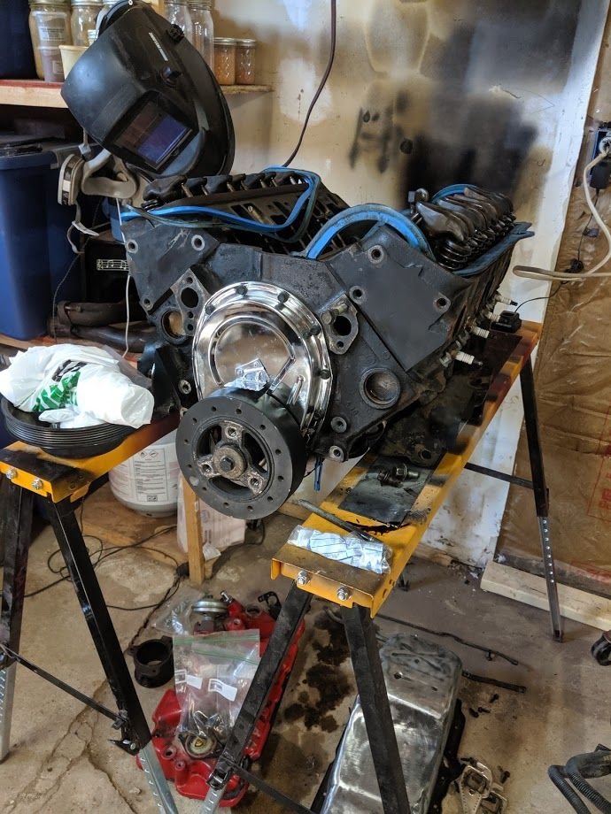

I managed to work on the oil return fitting today. I wanted to take off the oil pan, but I couldn't get the motor lifted higher enough without taking off the transmission and exhaust, so I just left the motor hanging and worked with the pan disconnected under the motor. The oil return kit I bought came with an aluminum fitting to weld to the pan instead of steel, so I had no way of using that. I just took a 10AN fitting I had sitting around, drilled and tapped a hole, then cut the threaded portion of the fitting down to make sure it wouldn't interfere with anything inside the oil pan. Once that was done, I threaded in the fitting while applying normal JB weld to the threads and tightened that in there. I made sure to shover JB weld around the edge of the fitting too so hopefully I won't get any leaks. Once things seem good, I'll try and do a quick re-spray of the oil pan since I used carb cleaner which messed up the paint on the pan..

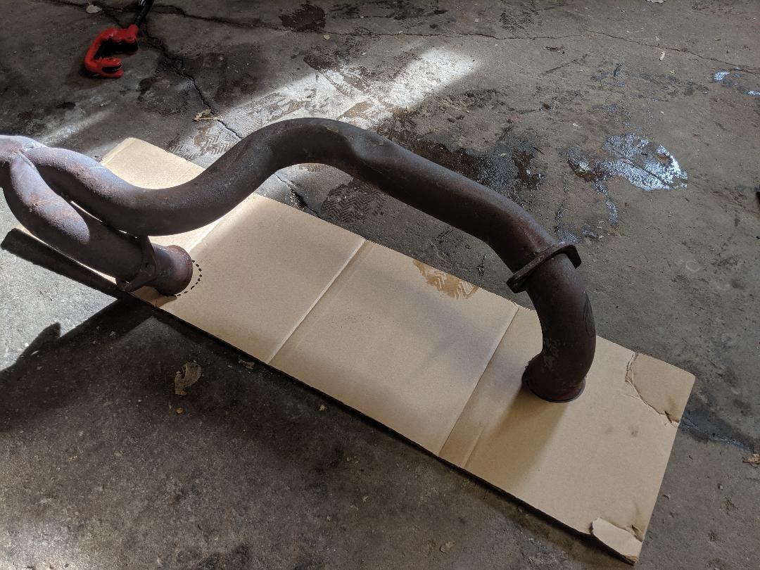

I was originally going to try and route the exhaust inlet for the turbo up and around the driver side to the turbo using the stock exhaust manifolds I picked up, then have the intake from the turbo to the throttle body route around the shock mount kinda like this:
However, I might want to try and keep the ceramic coated hooker headers I have on. I don't know if this really is the best idea, but it would be significantly easier for routing/welding/piping if I kept the hooker headers, and routed the exhaust forward, under the subframe, towards the underneath of the turbo (where the stock vacuum reservoir is.)
I did some measuring and it seems like I can cut and come right out of the y-pipe near the driver side control arm/subframe and bring the exhaust forward towards the driver side headlight area where the vacuum reservoir is. Even if I used 3" piping, it would break the plane of the ground effects and seems like it would be decently high off the ground, despite being on the front end. I think I would go from 2.5" off the y-pipe, then to 3" at the turbo connector (since that's the size flange I bought) so that should give me a little more room.
I figure it would be nicer to have my ceramic headers than the smaller stock manifolds. I did some reading and it seems like cast manifolds are pretty good at keeping in heat compared to headers, but since my headers are ceramic coated, I don't think there would be a big difference. Also, it think the better flow to the turbo would help as well.

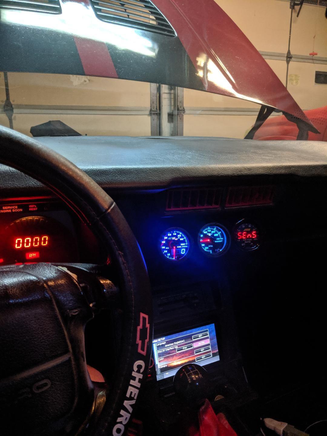

On a different note, I was able to get my gauges mostly installed. They are snug, but not fully secured in the gauge pod. I have to figure out a way to get them to stay snug since the pod I purchased doesn't have a way to actually fasten the gauges down. I may just use some black RTV on the back/lip (it should blend in with the pod and be mostly hidden on the back) so that I can remove them later if needed instead of trying to glue them or something. I haven't booted up EBL yet to check (I need to charge my laptop and the car battery too), but I hooked up my wideband to the EBL Flash computer as well as tapped into the fuel pressure gauge harness to hook up to the EBL too.
Obviously the wideband sensor isn't in yet since I don't have the piping made, but the sensor plug wires are about where I plan on routing the exhaust so I'll just have to plug it in. I also have to make a vacuum port off my intake hat for the boost reference (which is needed for the gauge and blow off valve). Wiring up these gauges took significantly longer than I thought it would... It didn't help that my steering column pivot pin fell out and disappeared when taking off the dash top, which ended up disconnecting the ignition switch rod mechanism so I couldn't turn the power on. I have to pull down on my steering wheel to align the mechanism until the replacement pivot pins come in.
Now that this is done, I just need to splice in the new IAC valve and TPS sensor, and mock up the piping/mount the turbo! Then I should be able to get it started for tuning hopefully! I'm being overly optimistic, but I'm thinking it's possible I'll have the piping made by this weekend, but if not, then at least over Thanksgiving weekend!

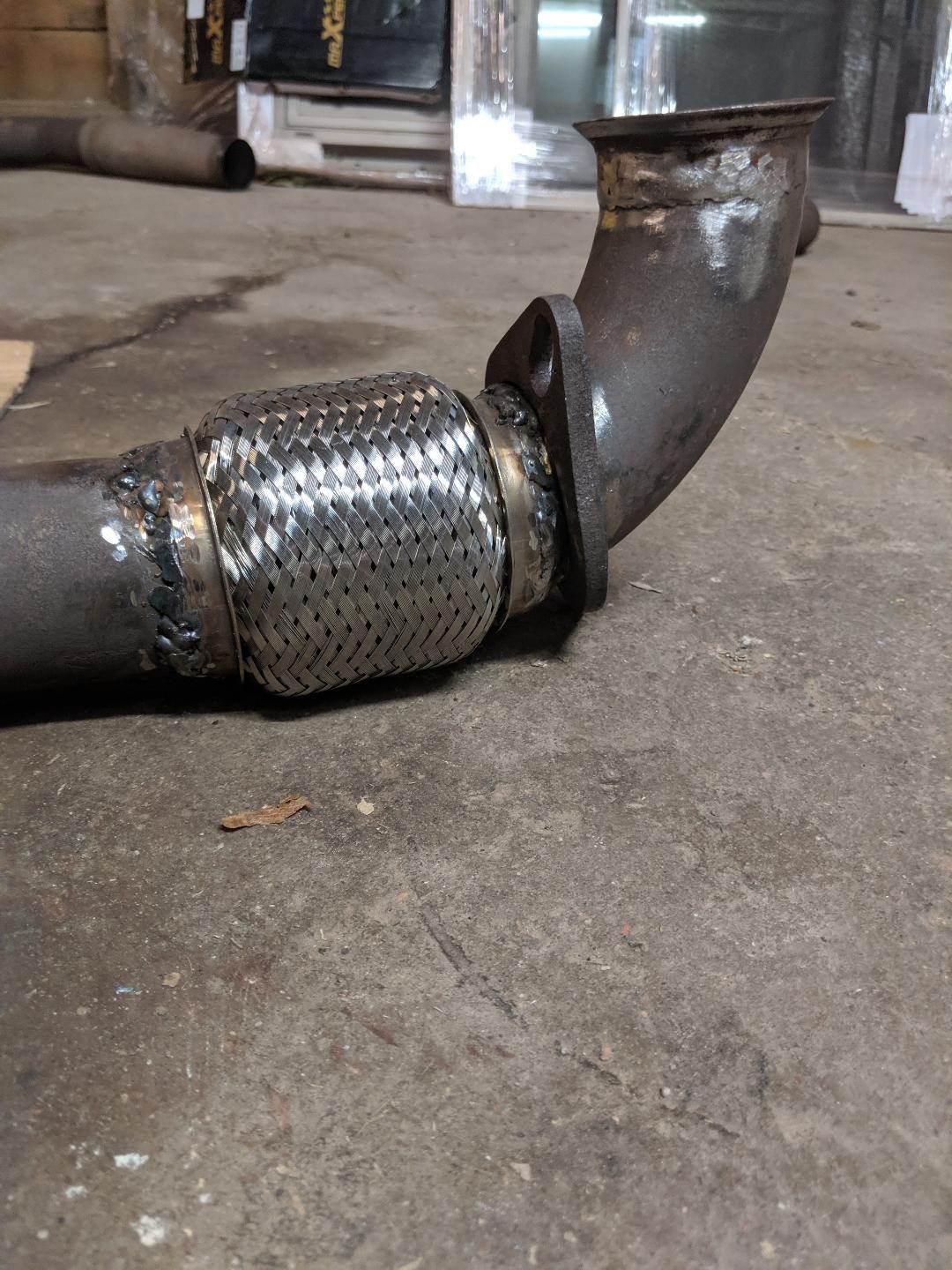

Here is what the completed Y-pipe looks like:
It's not super pretty by any means, but it fits up well. I just hope I didn't make it hang down too low in the front. I think it should be fine though. I'm going to try and scrape up the whole pipe after I know the car is running and hit it with some super high temp spray paint just to help prevent any rusting.
Here is the adapter piece at the end of the y that bolts to the turbo flange adapter (which is welded onto the car and where the blowoff valve bolts to):
Here is what some of my welds came out looking like now that I have things set up better:
Not all of them were this pretty, but they were exponentially better than before. When I was tacking pipes from under the car (with everything partially bolted up for fitment), it was pretty hard to get good welds, but they still were better than before.
I now just have to make the downpipe with the o2 bungs, install my replacement injectors, and start trying to tune it!

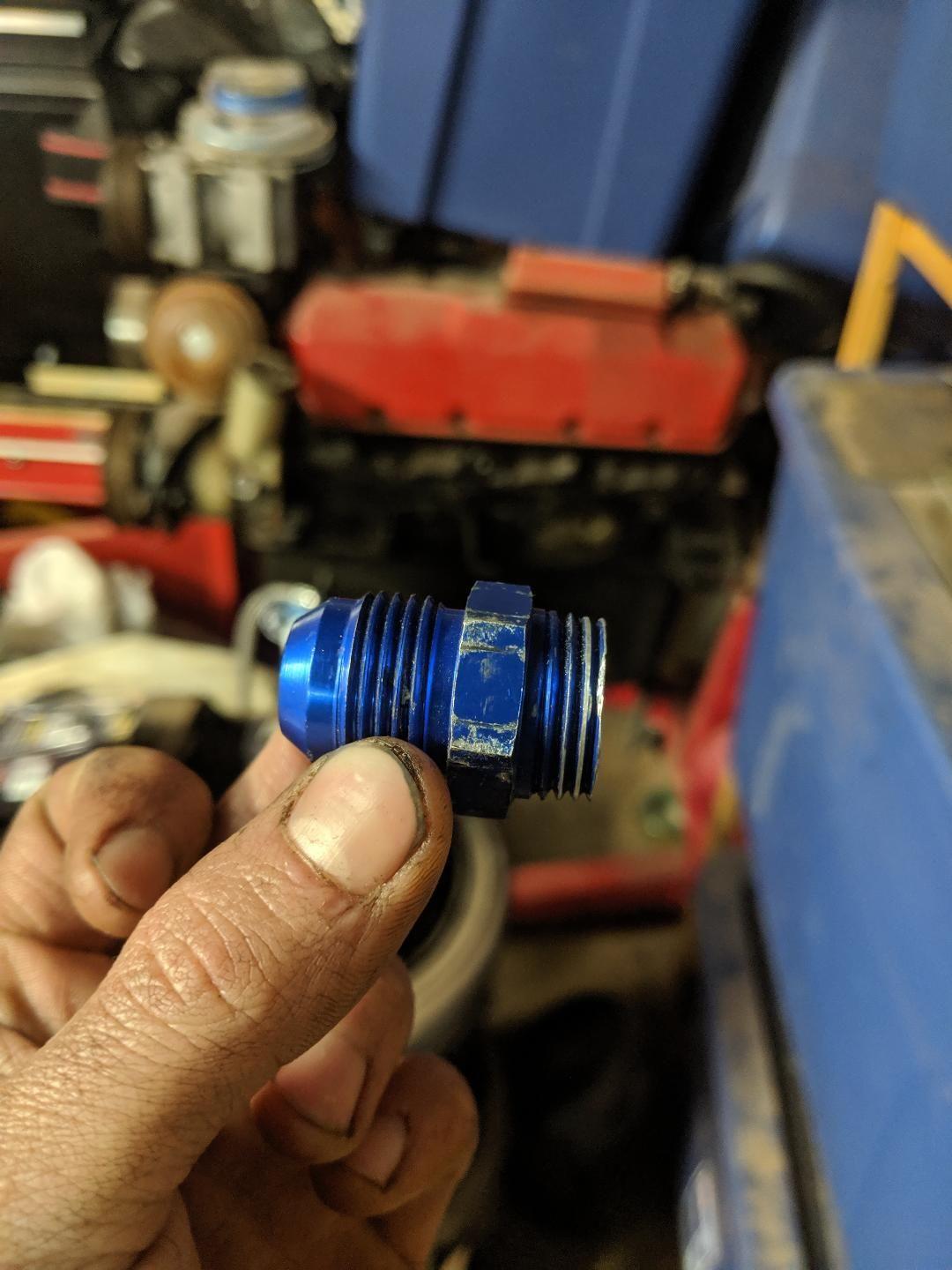

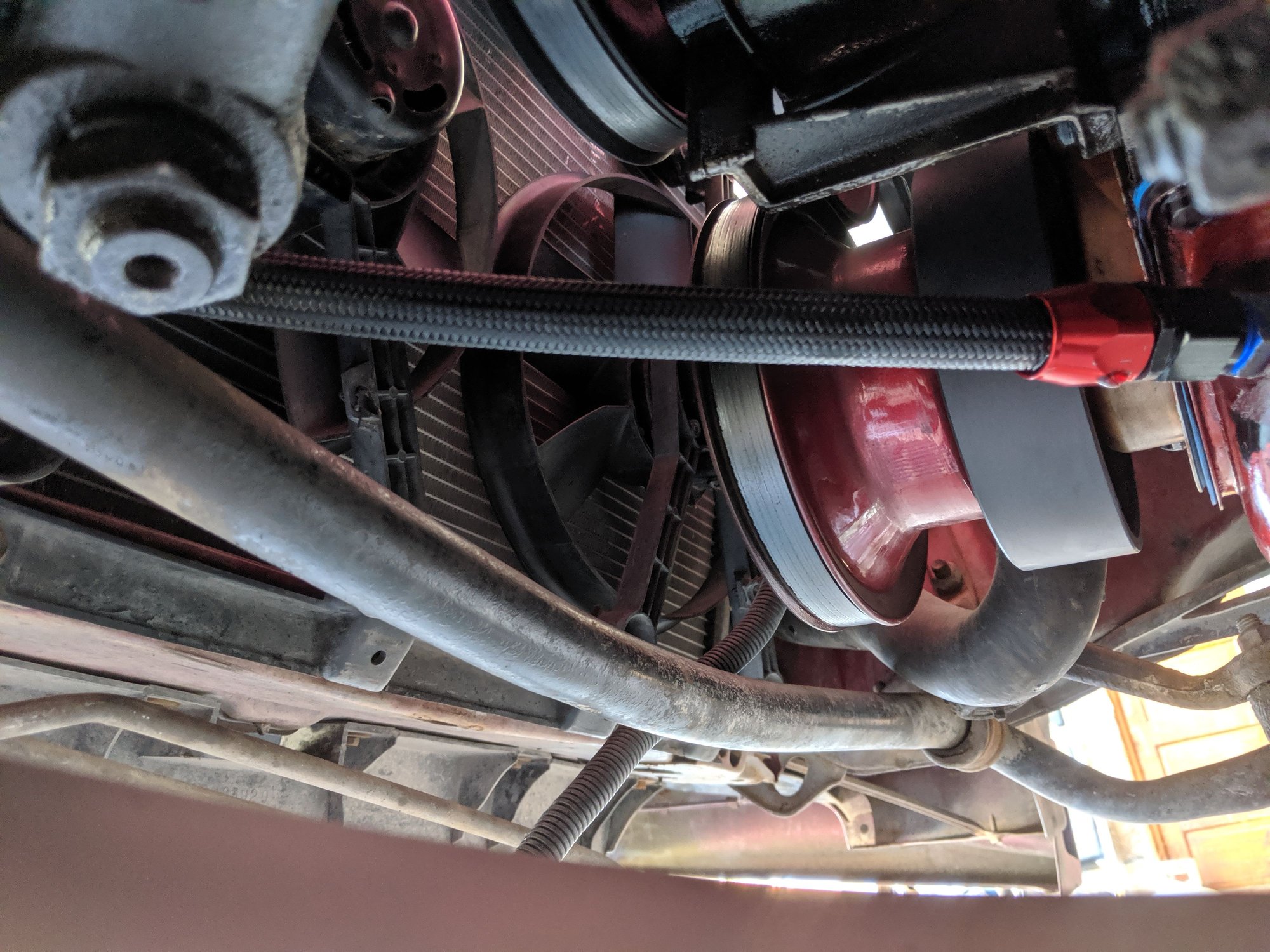

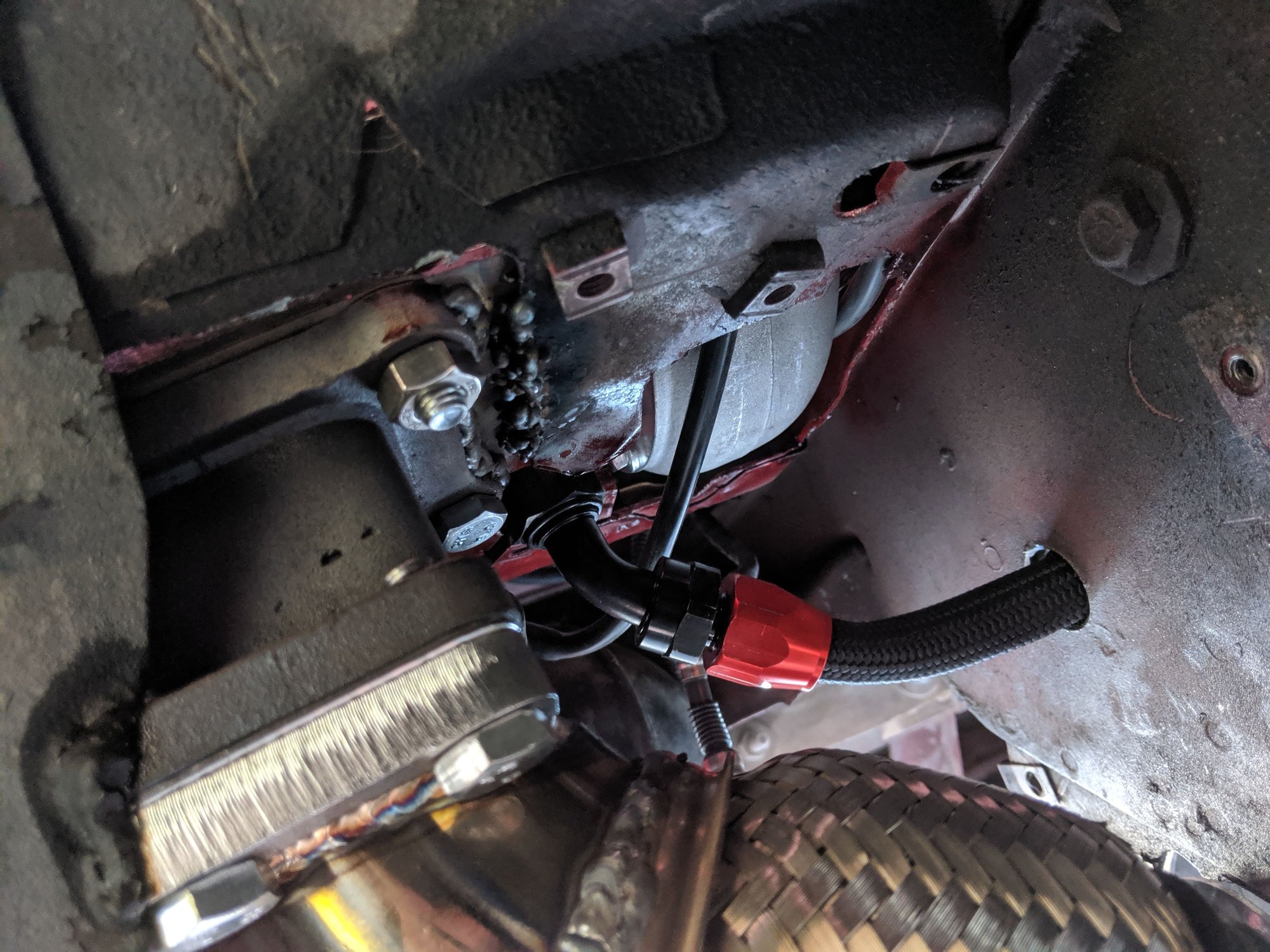

Well I was a little optimistic of my oil drain line setup but knew it probably wasn't going to cut it... I'm going to have to run a sump/pump setup because the turbo location is a little too low for a good return angle and my turbo was smoking quite a bit. Even if the angle was good, the line was a little sketchy where I drill through the frame.
The supply line comes from the back top of the motor near the distributor with a 4an line and the fitting on the turbo is restricted. The return line is 10an, goes to a 45 degree angle but then quickly goes to about a 10 degrees angle to the pan for like two feet. I don't have any other way to route the hose without a sump setup. I'm going to do a quick test with the hose aiming in a jug to see if it stops smoking.
Here are some pictures for now though!
If anyone has any good ideas for pumps/sump (on the budget side) I'd like to hear it! Unfortunately, I think I stated earlier that my daily driver F150 blew a head gasket, then my Bronco's driveshaft broke. I fixed the driveshaft but then the axle tube cracked (or an old crack I missed for pretty big). So basically I'm a little low on funds and out three vehicles... I'll get things working though. I'm excited about the turbo on this, I just need it to stop smoking so I can start tuning!

It's been a while since posting but I have done some work. My computer failed and other things happened so I didn't update much on the forums.
I had a pretty bad boost leak with the stock exhaust manifold gaskets I used under my hooker 2055 headers. I ended up buying some fancy copper gaskets and they were much worse (the port shape was too large). So I bought some Mr. Gasket round port aluminum crush gaskets and those did the trick! Boost seems to start building around 3k +/- 200rpm depending on throttle. My tune is still super far off, so I think I could build boost closer to 2500 if my fueling and stuff is right. The vacuum/boost referenced fpr is going to make tuning for fueling a little tricky, but I should be able to get a hang of it. At lowish rpm and low/moderate throttle, my car runs super lean. However, if I give it a heavier throttle, the vacuum drops so the fuel pressure rises, and it runs pretty good to a little rich.
The eBay waste-gate I bought said it had a 8lb spring, but it was opening up around 4-5lbs. I added a small vacuum tee in-line with the wastegate to bleed off pressure and it now boost up to 7psi before opening. I would like to see if I can get it to be around 10-12 once things are all said and done. I'm not sure what these blocks can handle but I don't want to push it too much on a stock block.
The turbo definitely makes a big difference, 7psi feels pretty good and can break the tires loose at 30mph. My tune is still super awful, so I'm not being too ridiculous, and I feel like it could get much better with a tune, but it's much faster than it's ever been that's for sure.
