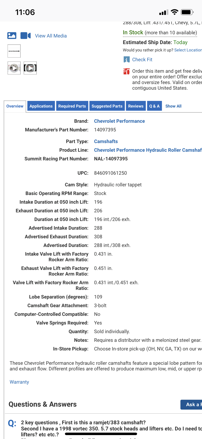

What are the specs on the towing cam?

I haven’t put a gauge on it yet, I don’t have the fitting to place the gauge inline. The fuel pump was replaced a few years ago, the filter was changed with the engine install, and the regulator was rebuilt yesterday. It did seem odd that the spring in the rebuild kit was shorter than the original.
I will attach a photo from summit of the cam specs.

Your cam has enormously more duration than the OEM TBI cam, or even the Vortec L31 cam. MAYBE that's causing your problem, or part of it. The cam you chose is pretty mild, but the OEM cams have a frightening lack of duration. They're BEYOND "mild".

I regret picking this cam for the truck now. Now that you say that, it got me thinking. I bought the truck minus the engine, but all the stock TBI stuff was still there. I got a junkyard 350 and threw it in there, that engine had an occasional backfire. I wonder if that cam could of been slightly more than the TBI cam? I need to get the adapter so I can check the fuel pressure. I will check compression on all the cylinders also. I need to verify all the constants before I start throwing parts at it. The cam was not degreed, just a dot to dot line up and pray it’s right.
