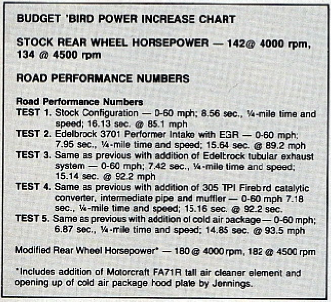

Nice article, thanks.
Overall they picked up 38HP @ 4000 rpm (Edelbrock 3701 Performer intake, Edelbrock TES headers and Y-pipe, TPI catalytic converter and cat-back exhaust system, and home-made cold air package). The CAI alone was worth 18 horsepower with increases of .31 sec (0-60 mph), and .31 sec and 1.3 mph in the 1/4 mile. So yeah, these engines were significantly choked off from the factory.
