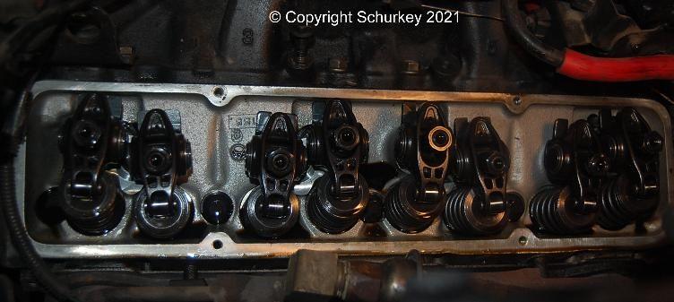

'88 K1500 5.7L
Vortec short block, including cam, but with TBI damper and timing cover
ZZ4 intake manifold, Trick Flow Twisted Wedge heads w/ 1.6 rocker arms. Edelbrock "TES" Shorty headers, 3" high-flow catalyst and exhaust pipes/muffler. Heated O2 sensor. 4 degrees initial timing instead of zero.
Stock tune plus a few extra PSI of fuel pressure. The colder it gets, the more I think I may need to jack-up the fuel pressure some more. Ran great last summer/fall. Probably "needs" a custom computer chip, and maybe another couple of degrees of advance. Not going to get either until spring; unless the really-cold weather to come, makes it run worse than the mild bog I have now as the engine warms-up. Runs fine when fully-warm, runs fine totally cold. But as it warms up, there's a bog on acceleration and after each shift.
