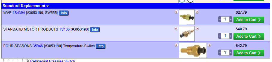

Sw555 wells

I don't mean to question you, but as i looked up the part, it doesn't show that it would work on a 92 camaro or say its a low temp switch

Re: HELP Low temp fan switch for 1992 camaro

i have been, i see many switches but none are low temp

210 degF on, 205 degF off (Wells SW555, Standard TS-136) 3/8 NPT x 14 threads
Listed for '86-'87 Regal & '89 Firebird

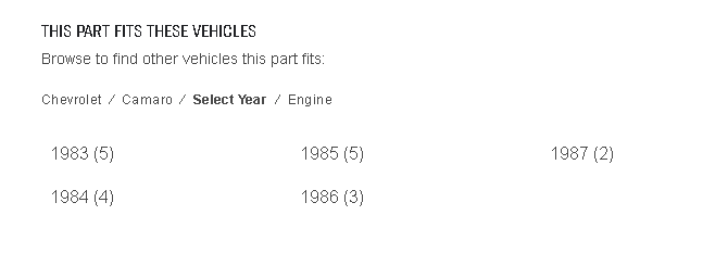

so i was going to buy the wells SW555 fan switch and it asked for the model of my car, after entering all the information, it says this product won't fit your vehicle any other suggestions for a low temp switch

Read the previous posts your head hole is 3/8 npt iirc connector is the same. Although not listed it works

Yes...thats because the search / parts finder searching for the STOCK regalement switch.
as long as the switch fits / functions the same, it will just ground the fan at the lower temp...you are doing something custom so it will not "match" you could even do a different swotch size with fittins / different wiring connector etc.. but thats way more work.....
