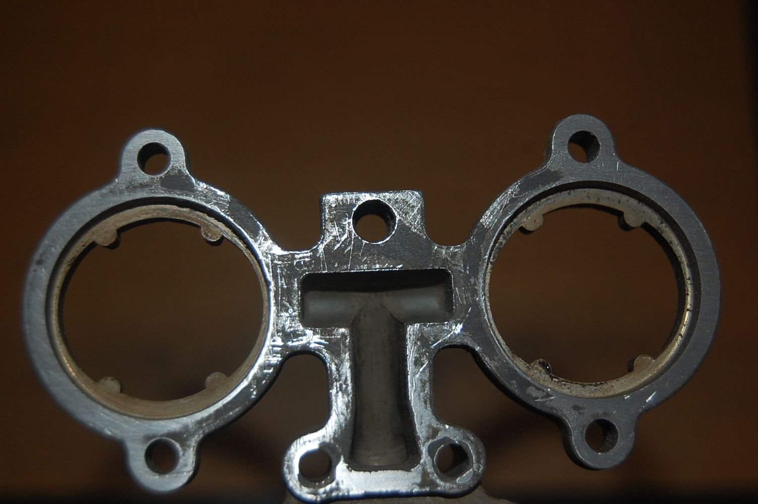

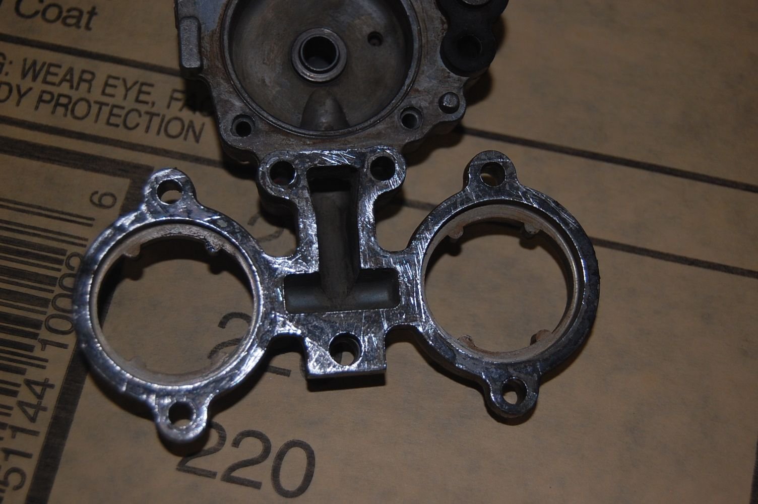

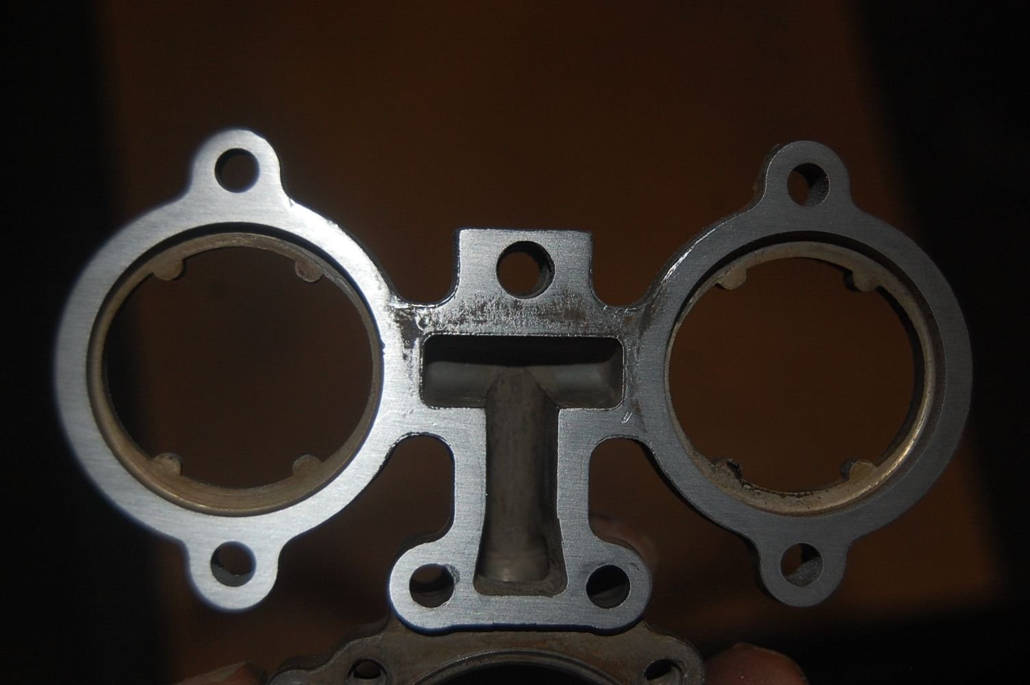

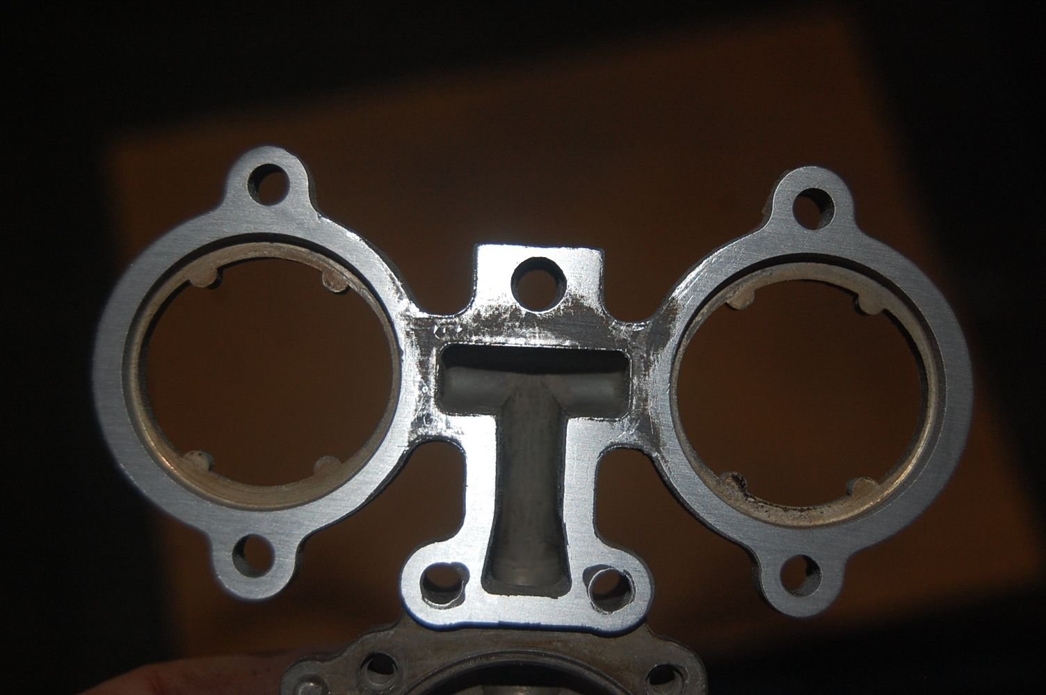

As said in a previous post...put the 305 injectors into the replacement pod. While the pod is apart for the injectors, verify that the gasket surface is genuinely flat.
I used 220-grit sand paper on a piece of window-glass (for flatness) to take the warp out of mine.
