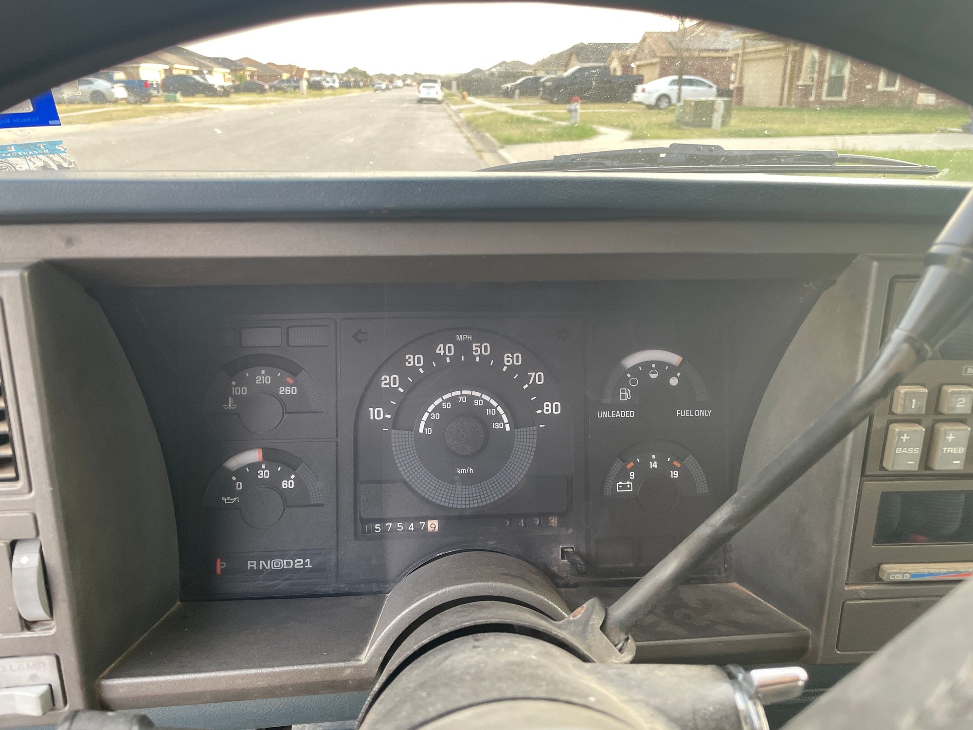

Re: HELP, injector won’t spray
Originally Posted by 92RS-HeritageEd
Hello! While I know nothing about a "1990 c1500 5.7 350 TBI"... I know a HECK of a lot about 1 of 2 TBI Injectors Spraying. This happened to and still happens with my 1992 Camaro RS with the 5L TBI. My issue was narowed down to likely an electrical wiring grimlin I believe after following ALL the troubleshooting you mentioned and having the EXACT same symptoms, I even swapped ECM's.
One thing not mentioned in your post was SES Light Codes? Example, Code 44 (runs lean when one injector dies).... Got any? Or you just notice a "loss of power"? How about your RPM guage when this issue occurs? Does it go crazy jumping around?
I got no check engine light or code, just noticed the loss of power. My dash actually doesn’t have a rpm gauge
