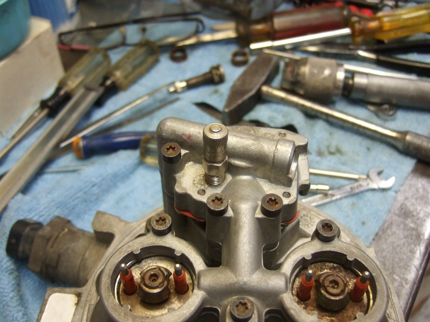

You can do this;

Originally Posted by scooterwrench
You can do this;
That is awesome. I’ll eventually do this, thanks.

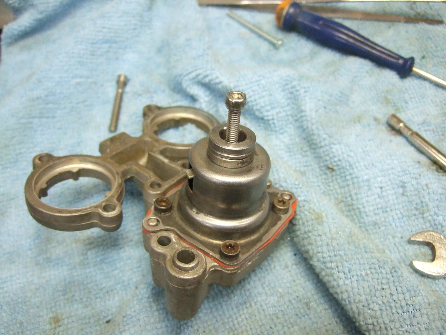

You will need to take your regulator apart to do this or you will fill it with aluminum chip.
For sure. I’ve had these apart so many times I’ve got it down to minutes haha. This is a mod that seems practical for long term. I’ve known of some that just seem sketchy to leave under the hood but this one looks legit. Thanks again.

Another tip is DON'T use that metal cap. I just put it on there so people would know what they're looking at. I replaced it with a plastic tire valve cap,I'd rather it sucked it down through the motor than the metal one if it were ever to rattle off.

Originally Posted by DrPockets
That seems like a fantastic idea.
Probably the truest representation of the fuel pressure where it matters, too.
Thank You Sir,
I was rebuilding the TB and knew I was going to have to reset the pressure and didn't have one of those inline taps. I made the regulator adjustable too.
Next trick will be making a spring housing that is sealed and taps into the vacuum nipple for a VRFPR. Not sure if it's ever been done with a factory FPR so I may be crash test dummy. That TB is off the 305 that's in ol Smoky(my truck)and I'm not going to waste the effort on that one but eventually I'll be replacing that POS 305 with the blueprinted 355 that's in my '78 Elcamino. That engine will be getting a 454 TB.
