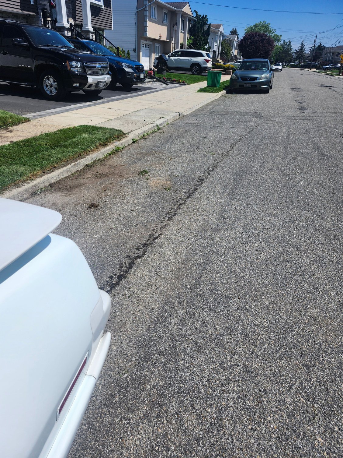

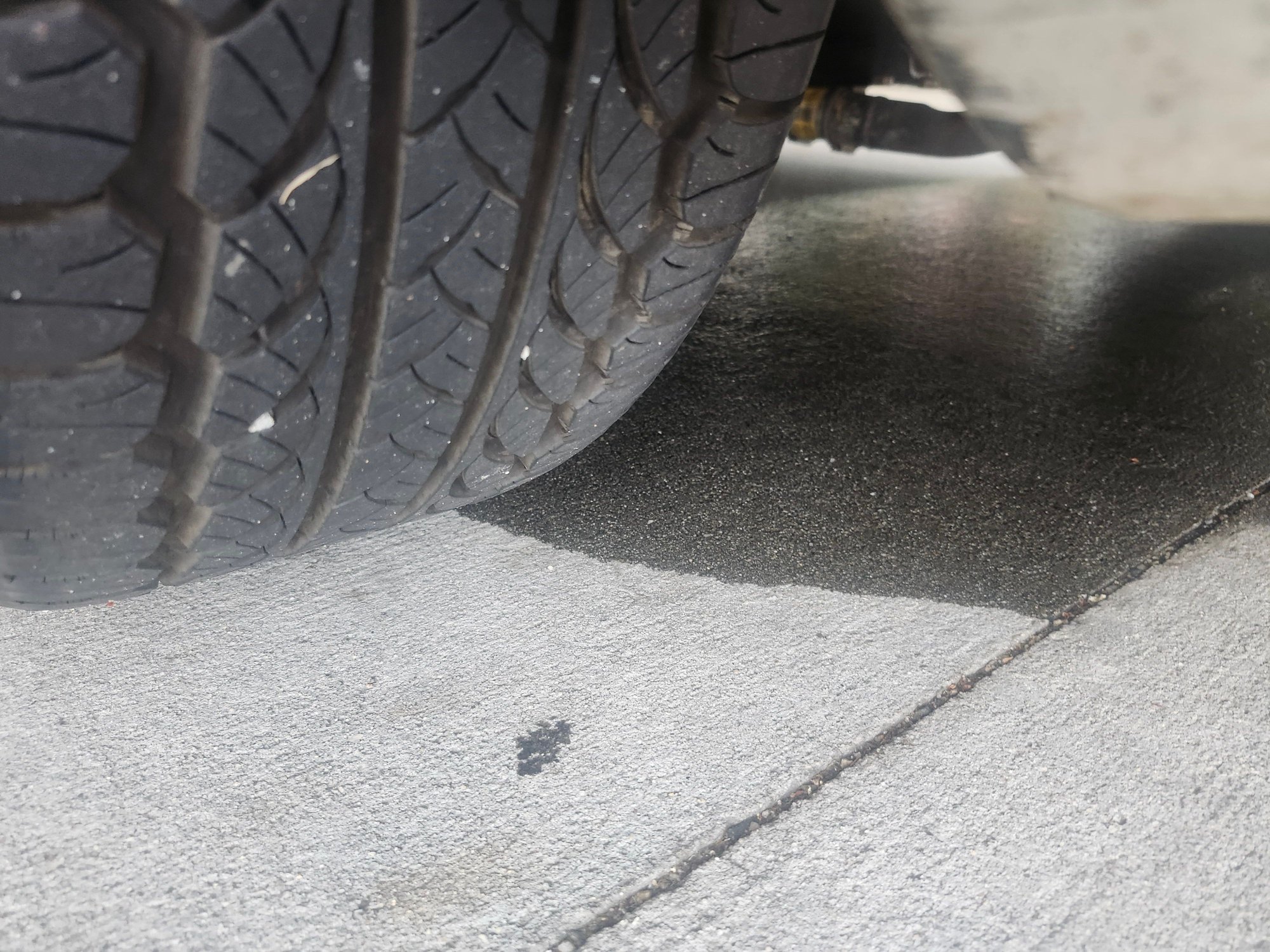

I drive my Trans Am locally. When I go on long drives about an hour drive, I start to smell fuel. I look in the side mirror and I see a trail of fuel under the car. I watch my gas gauge drop. I replaced the vent valve and the gas cap thinking it was that. I filled up a full tank of gas, drove home smelled fuel looked under but no spots. Anyone knows what it is
