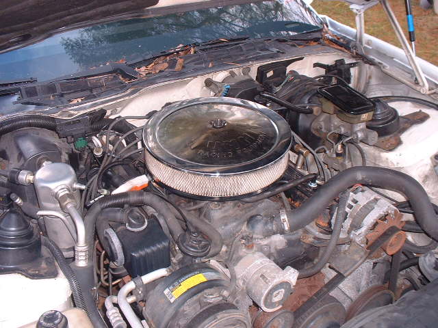

I use a Summit Non drop air cleaner, 14x3.
I removed the spacer ring (it's tack welded on usually, though mine basically came off on it's own) and relocated the IAT (sensor that is plugged onto your aircleaner) to the rear wall near the A/C stuff. I suggest removing the spacer because this way air flows from every side better instead of just downwards like it is the case with most drop base.
I also had to make the air cleaner stud longer which I accomplished with a screw I sawed the head off and trimmed down to about 1in. and a coupler I cut sown to about 3/4 of and in and got it to the right height. I did also have to trim some threads from the oringinal stud so it would fit better. Some people have been able to get the ait cleaner on w/o extending the stud, and some invert the cover.
I'm attaching some pics of the stud as well as the aircleaner installed. I have to thank Nevermore for the original idea on making the stud

Here is the stud, since I caould only attach 1 message to the post
BTW, I know the engine looks really dirty and rusty, but the car sat in someones back yard for over a year before I bought it and is definately a work in progress

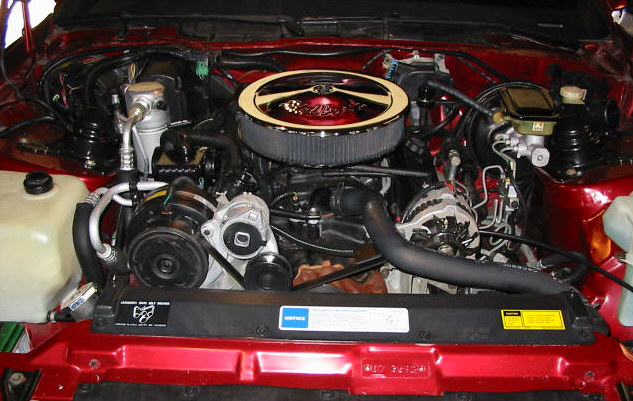

Here's mine, it's a 14"x3" Edelbrock with a 3" K&N element.

Nice and clean GKK!!!!!
