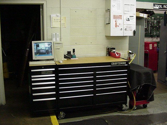

They look a little bigger, but the runners look shorter. I will try to attach a picture of it.

I will try again!

AHHHHH!

Hey, theres the picture of the picture on the computer

WOW!!! That's a huge Computerized Craftsman intake! Oh, wait a mintue... that just a tool chest. Where's the intake???

Nice wheels on the Tool Chest!!

You guys like those wheels huh! And on that computer in the computer there is a picture of the same thing.
