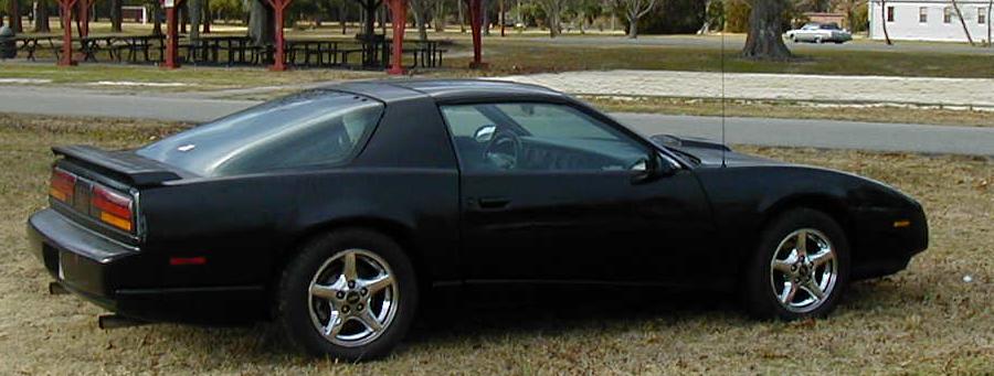

Hey firecrow what kind of hood do you have or should I say scoop? Looks like a Trans Am shaker or it it just a stock Formula hood ?
Steve
Old Mar 14, 2002 | 06:33 AM
91Firecrow305TBI's Avatar
Joined: Apr 2001
Posts: 333
From: Hampton, Va, USA
That hood has a fake shaker scoop bolted onto it. It was part of the Bandit II package, that had all of the pinstriping, hoodbird, etc. Right now I have a 86' Trans Am hood on it with a Harwood 2 1/4" cowl scoop to feed my car fresh air.

I was hoping you might have used a real shaker scoop. Oh well I'll just have to make my own.
Steve

I do have one from a 80 or 81 4.9 T/A. I did not use it because it would be too hard to get it to work. I know there are places that will make them custom to your car. I know someone who knows places. Let me talk to him, and I'll try and pass on the info.
Clint
