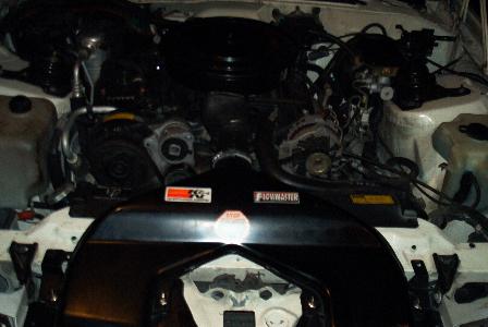

i have a 4" cowl, but am running ram air through a TPI set-up with the snorkel going behind my grill. here is a pic. which would be better for me, ram air or open element since i have the cowl? btw, if you are confused, its a TBI original air cleaner housing, with a TPI intake.

Matt, I really like the look of your set up and have considered it myself but I think it is short on air. I bet it flows a lot more than stock but it still is limited by the 3" single hose. I have thought about running a single 4" hose and modifiing the tpi scoop but I still don't think it is enough for 300+ hp.
