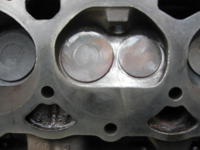

I had a "smoking start-up" issue going on ('89 RS 305 TBI), amd decided through trawling the boards is was most likely valve stem seals. I decided I'd go over the top and booked it into a shop to replace the entire top end gasket set. He pulled the first head and showed me the hardend seals and the oil dripping through onto the top of the vavle seats. Bingo, the right call.
Wrong (maybe!) He pulls the second head and gives me one of those famous sucking through teeth type of calls. I have a cracked head, that has penetrated the water jacket. Result, a great steam clean of that particular chamber and piston top. So maybe the smoke was a mixture of water and oil.
However, cut to the chase. These heads are rarer than rocking horse do-do in the UK, even for one from salvage. Is it possible to channel out the crack, weld in a line, and then skim the head back down? I really don't want to call the bank manager for a mortgage to ship a new/reworked head from over your side of the water!
It's an iron lightweight, LO3, engine code E.

Ouch! Not a good place for a crack. I would be wary of welding it, but if you ground a deep 'V' and relieved the ends of the crack with a small drill, you might get away with it using the proper filler material. Unfortunately, we're spoiled. It is more cost effective for those on this side of the pond to recycle the part and replace it. But try getting any Austin or Bentley parts around here...

Dear Master,
Many thanks for your comments. I'll see how the motor runs with one head off a 350. Could I fit a blanking plate on the other (dark) side and run it as a straight four?
What would this improve the MPG to?
Look..Ok, I know a welded repair is not the right thing, I was just asking. I'll ask my sister in Florida to stick a set in her hand baggage when she visits in the summer.
