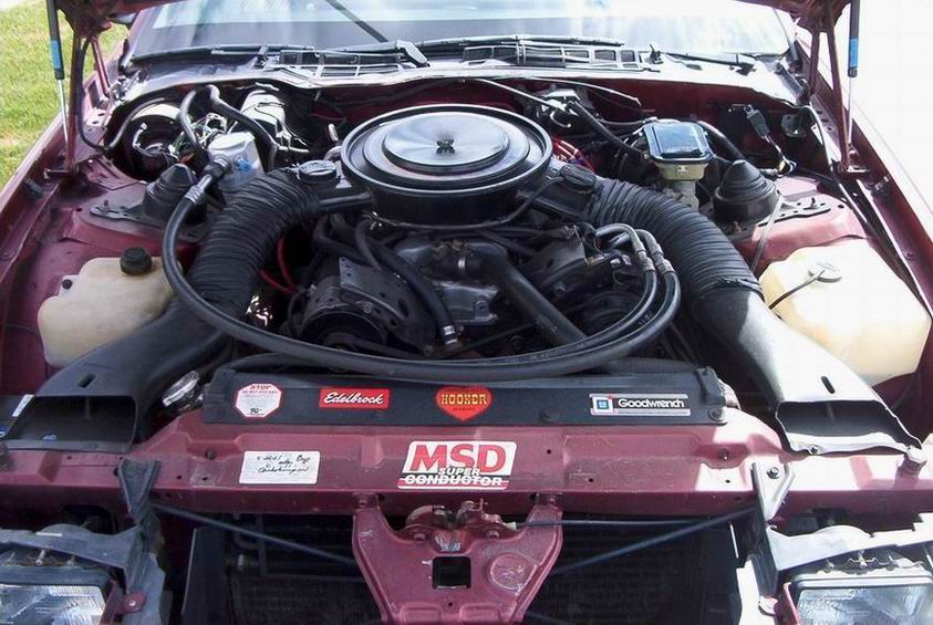

Old Jul 31, 2002 | 04:30 PM
Sitting Bull's Avatar
Joined: Jun 2001
Posts: 3,238
Car: 1986 Sport Coupé
Engine: 305-4v
Yes, I've also heard that some of the Firebirds didn't use dual snorkles but had cowl induction through the hood.
Very cool, too
Of course, my little old LG4 has a retrofitted dual snorkle, which is mucho cool looking, as well :sillylol: :sillylol: :sillylol:

Old Jul 31, 2002 | 04:33 PM
Joined: Jun 2001
Posts: 3,238
Engine: 305-4v
Here's a picture.
