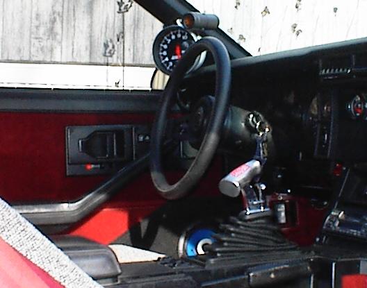

I'm confused by your question... But, yes, the stock tachs are known to be not accurate. I was given a 5" Autogauge Tach with shiftlite, retails for $100 in Summit. You can hook it up anywhere, and basically you hook up wires for the power and the other wires go to the distributor.

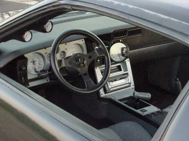

yeah i love my aftermarket autometer tach.... i dont know about the stock gauges being off.. i just like the looks of the big 5 inch tach with shift light. Installation is easy i think there was 4 wires, one was the green wire that goes to the distributer, black was ground, white was key switch, and blue was power up when you turn your lights on.

i just looked at all the small wires coming out of the distributor. you gotta find the white wire. mine were real dirty so i cleaned them off and when i got the white one i spliced the green wire from my sun pro 5 " tach into it and ran the power and ground wires. works great and also made me realize howw much off the stock tach was
Old Dec 16, 2002 | 11:33 PM
TBI305Camaro's Avatar
Posts: 2,378
From: Barboursville, WV
how far off is the stock tach? I think mines off because it hardly stays running with a 500rpm idle...750 idles fine tho.
I like the gauge pod on the pillar. I want to do that soon with a new oil pressure gauge and tranny fluid temp.
BTW what guages are those inplace of the old ones?? I like the looks of them. and how hard was it to install?
