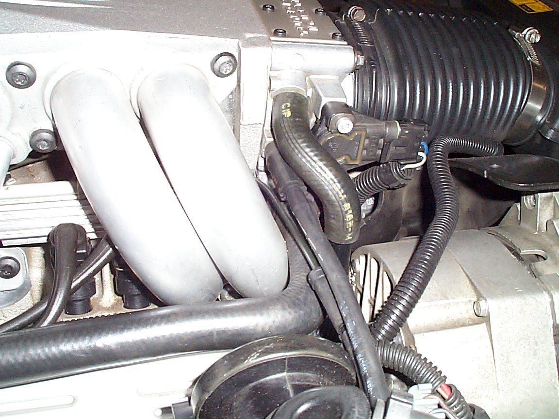

Check the fuel pump/ECM fuse in the black plastic holder clipped to the right inner fender (near the battery). It's a 20A fuse, and if it was somehow disturbed or wet down with coolant, it may not be connected well enough.
Old Oct 2, 2002 | 04:20 PM
Vader's Avatar
Posts: 19,691
Likes: 319
BTW - The holder is right next to the coolant overflow tank, so I'm suspecting it may have been wet down with coolant mix:

Thanks for the info - checked out the fuse and is ok. I have replaced the MAF sensor and burn-off relays and now the fuel pump relay is no longer making a noise but car still starts then dies. Have tried pumping the gas but car still stops. Have noticed that if left at idle that just before it dies the revs go up slightly. Could it be a problem with fuel pump or IAC valve?
Now thinking it could be a vacuum problem - have noticed that the vacuum hose entering the throttle body near the IAC valve from the CCV has a t- piece with a length of hose attached but unfortunately it is not attached to anything at the other end. There is no indication of this hose on the diagram on the hood or any other vacuum diagrams I have seen. I can't see anywhere that this hose should be attached to.
Any help is appreciated
