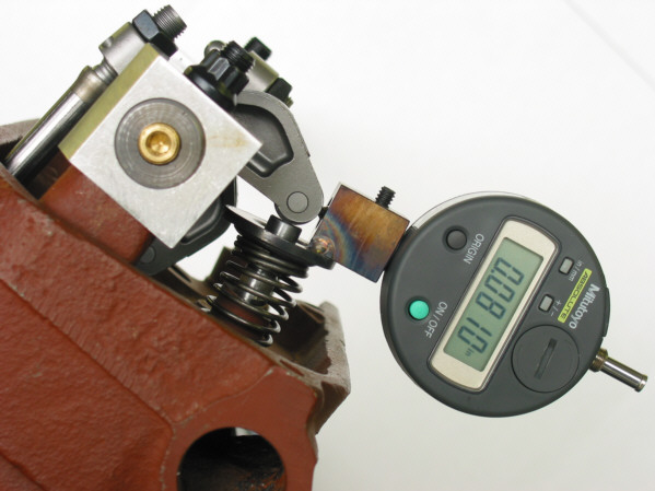

Yep, Sofa is correct for best lift. Look at it this way. The more side to side movement of the roller across the valve tip the less vertical movement there is that actually lifts the valve. I have found that usually requires a longer pushrod.
I actually made up a dial indicator similiar to the one in the picture to get mine dead nuts. However I made mine to clamp around the retainer. I was able to get it around .032" of total movement. My cam has .570" lift.

The geometry question is a more complicated one that it might at first appear. That's why I mention the cheap plastic checker tool- it's basically fool-proof and plenty accurate for what 99% of people need.
Going by rocker contact pattern is more difficult to do (easier to make a mistake or misjudge something), AND you will almost always end up with sticks that are longer than stock. This is often the case becuase the "minimum travel" method is NOT HOW THE FACTORY DOES IT.
The factory uses shorter sticks which create slightly more total travel across the valve tip. But, as with everything the factory does, there is a method to their madness and I spent many hours figuring out why they do what they do. As it turns out, they're no dummies. Shorter sticks cause more movement across the valve tip at low lifts, which valve spring pressures are lowest. But when you get above the mid-lift point, however, where spring pressures are high, the tip of the rocker doesn't move hardly at all across the valve tip. So they put less strain on the rocker, valve stem and valve guides when spring pressures are high. This is smart engineering, especially considering the factory never used roller-tips on any of their factory engines (at least not older Gen 1 small blocks).
I have now adopted the factory geometry method for ALL street engines I build (and I build almost nothing that doesn't drive on the street).
The plastic checker tool is set up to give geometry that is roughly equivalent to how the factory does things. It can NOT account for differences in max valve lift from cam to cam. It doesn't know what mid-lift point is for your particular cam. It is built around some "typical" street performance cam max lift number- about .500", near as I have been able to figure out. So it's not perfect. But if your cam is in the .450"-.550" lift range, it's pretty damned accurate. It also can't know what the geometry of your particular set of rocker arms is (yes, rockers can vary in where they place the pushrod cup and rocker tip in relation to the fulcrum point), but again, most typical bolt-on street performance rocker arms are set up very similar to eachother and to factory rockers. And the tool is STILL very accurate every time I've used it on many different engine combinations.
It is close enough that I always use it as my first check. Beyond that I get more sophisticated to dial in the final stick length (I spend a lot of time on rocker geometry- more than most people do). But that cheap little tool is good enough that if you trust nothing else, it will still give you sticks that are plenty close to optimal 95% of the time. Even if you build only one non-stock SBC engine in your life you should buy that tool.
