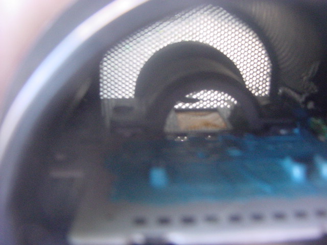

My SES light has been on since I got it from its original owner. I've gotten rid of every problem except it's still coding 34 - Low Voltage / High Vacuum from MAF. I tried unplugging the MAF and it still runs the same, which I've been told means that the MAF isn't the problem in this case, though, there are some visible problems with it (I heard that the orange piece is supposed to be flat ... and mine is kind of .... bubbly)

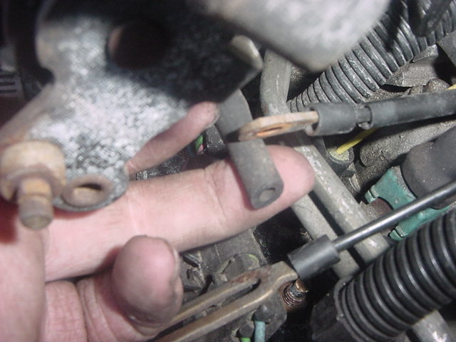

Oh ... started taking **** apart today when I noticed this ... is that normal? Or should there be another line connecting to something ... (I'm thinking it's missing something)

hehe, forgot the pics :x btw, this is right under where the intake is, and that tube is attached to one of the ends of a T-connector ... so I'd imagine that it's missing something. I'm just not sure what though .... thanks in advance.

I found the problem (I think,) I'll take pics when I get everything hooked back, just for the sake of possibly helping someone else out. I see alot of that "USE THE SEARCH BUTTON" going around

Fixed what I thought the vacuum problem was, car runs alot better, but the SES light is still on, coded 34, again. Did a visual inspection of the MAF, no cracks or anything, but the orange square in the middle is all bubbly, and IIRC, it's supposed to be as flat as possible ... so I'm gonna try replacing that shortly, and see how it works out.

Replaced the sensor today, no more SES light, yay. Now for my brake cables ... :x

Orange square in the middle?
Old Oct 6, 2002 | 10:02 AM
sub's Avatar
sub
Posts: 36
From: Waterford, CT
Erm yea ... just making sure I'm not crazy:
The "film" in the freq mafs.

Yep, zactly.

Andrew - Sorry man, forgot to take the pics ... I'll get em up by Monday, but I've got a busy weekend ahead of me (family birthdays and whatnot.) I'll try to explain it though ...
OK, stand (or picture standing) directly over the throttle body, with the intake pointing in your direction. The "T" I was orginally referring to it directly under the intake in the throttle body. There should be a plastic tube that's connected to it. If it isn't, then this is your problem Anyways, back to where it connects to ... It's behind the top pulley for the belt on the right. There will be 2 lines side-by-side up to that point (I hope ) I hope I explained it ok ... if you have any other questions feel free to post here or email me, and I'll try to force myself to free up some time to take those pictures for you.
