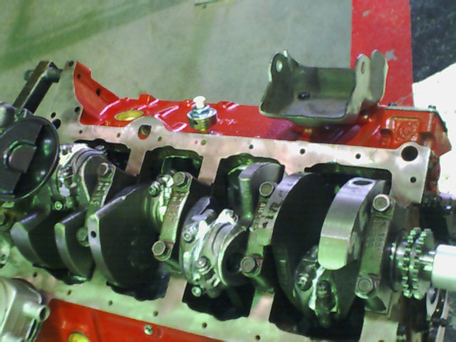

is it true that you only need .050 cam to rod clearence or would you guys reccomend a little more???
i took some pics, this is the best one the rest were blurry as hell.
sorry, it's a ****ty camera!!!!
i'll get some good one's monday

The same clearance specification should be acceptable for the camshaft lobes.
Incidentally, it's encouraging to see you're using a crank socket to turn the assembly, instead of a flywheel or balancer bolt like too many others have tried. Good thinking...

well, i was using the flywheel bolts and a screwdriver to turn it...... but when i found out we had the sockets i changed immidiatly!!!!
hopefully i'll be able to get better pics monday.....
