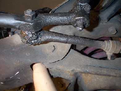

Ah memories. In all honesty you should go ahead and change them now while the motor is out, because if your motor is tapping on the hood in a year from now, you'll be sorry. First time I changed one of mine, it took near two hours of fumbling around with swivel sockets and extensions and such. I can now change them in about 10 minutes per side. My secret? Being a girl, I've got tiny little hands and wrists, and I just crammed my hand, with a wrench, through that tiny gap between the A-arm and the k-member. Of course that's not really an option for most of you guys. I've also heard that you can buy a cheapo wrench and bend it to a certain angle so you can get at that one PITA nut.

looking at viciousz photo it looks like you could jack the wheel up on the side your changing for more room where she is placing her hand. Did anyone else notice this.
