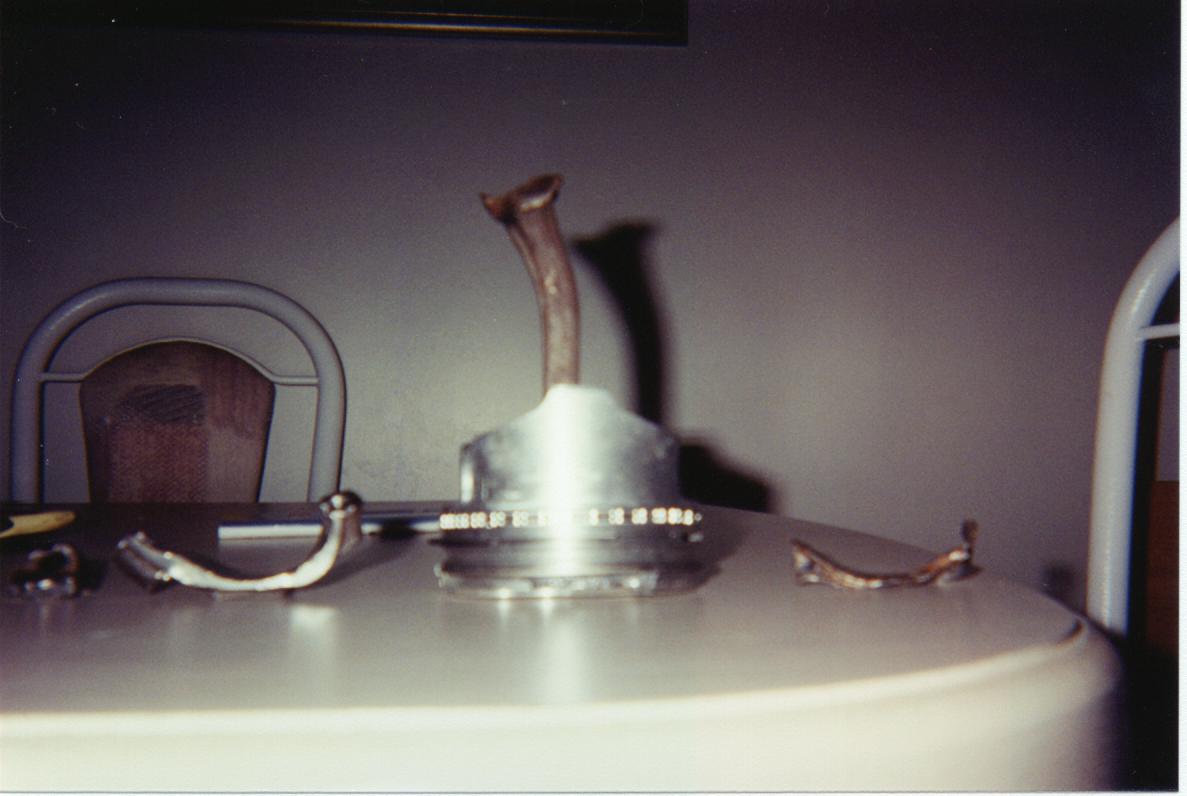

Here's what happened to me when I had my brother rebuild my motor at Votec. I bought everything new except reused the rods, and it didn't even dawn on me till afterwards that the old motor and rods had been hydrolocked, and my idiot brother never checked them for straightness. Not trying to put all the blame on him cause I should have known better and said something. I tracked it down to tweeked rods cause when I pulled the remaining rod bearings, half of them were worn down to the copper on one edge and they only had about one hour on them from brand new. So I'm sure that some of them were riding fairly hard to one side and one just let go when I got 3000 revs on it.

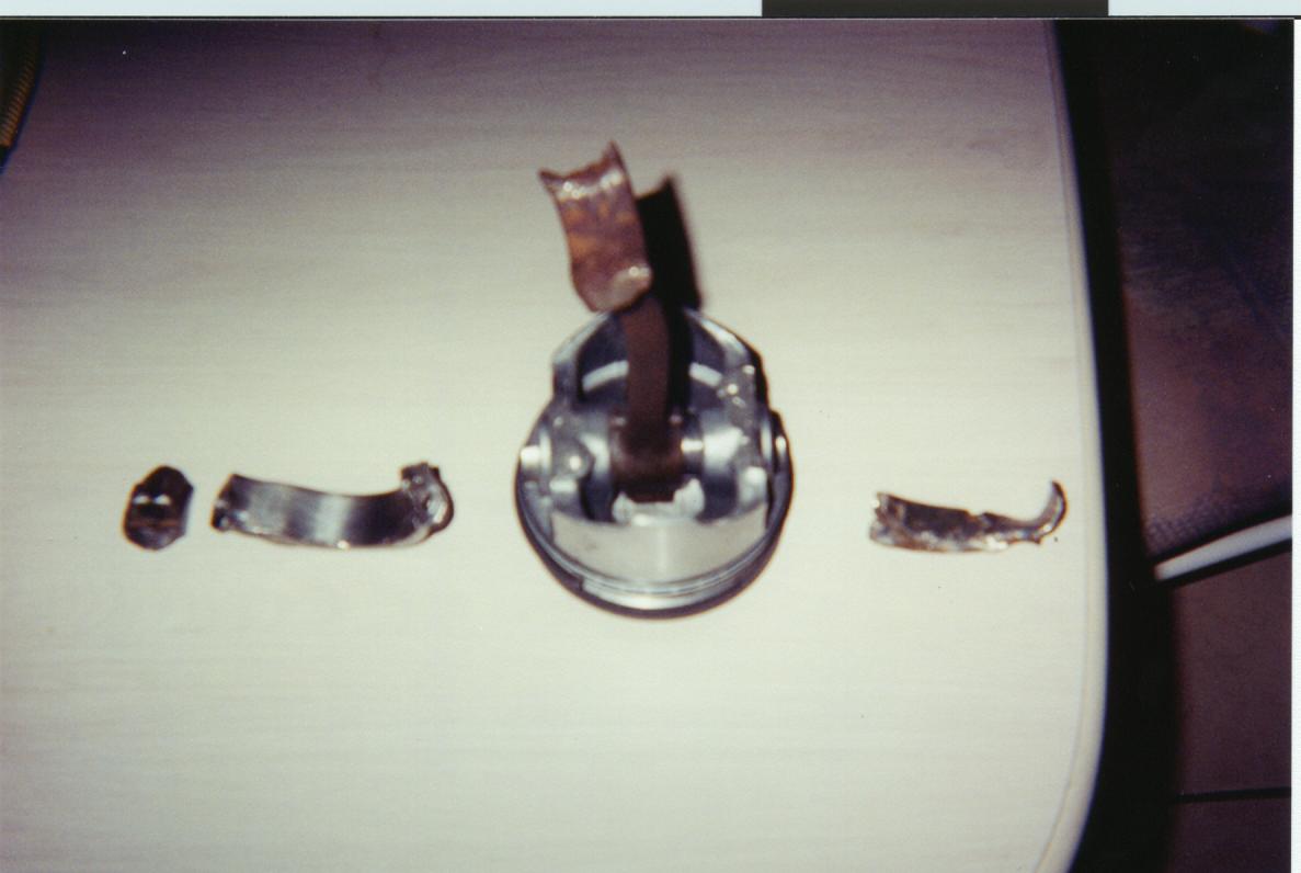

another
