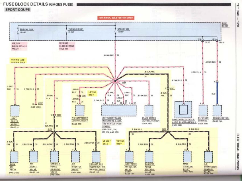

Ok, here's the update. Here's an 85 schematic for the gauge fuse. I'm going to disconnect the C207 connector tomorrow to eliminate those possibilities. Then from there its only a few more things. However, I don't see those starter wires anywhere. I'm only blowing the gauge fuse....is that what happened to you? Could they be in the circuit somehow? This is shows everything that could blow that fuse.....right?
Old Mar 29, 2003 | 01:54 AM
Iroc n roll's Avatar
Posts: 623
From: Hard hittin' New Britain, CT USA
Ok, i can't post it but its here
http://www.geocities.com/vtcamaro/Wire-Diagrams.html
Go to the 7th photo for "fuse block details" (it's in the first column).

Here we go:

U-Roc,
Yeah, that's the same schematic I have. C207 should eliminate a lot of wiring and possibilities.
As for checking the wiring with a multimeter, check the circuit with the fuse removed and the meter set on a resistance scale. Check resistance to ground as you connect and disconeect relays, loads, etc. Anything that has a resistance below 8-10 ohms should be an automatic red flag, and given the nature of the loads connected, anything below 15-20 ohms is pretty suspect. Most relays and instrument lamps should be at or above 35 ohms.

I unplugged the C207 connector, turned the key to the on position and I SAW GAUGES!!! The volt meter went up and my tach "zero'd". I pull the fuse and its ok. So, now the elimination of the culprits. If my car was an 87 I could cut the wire running to the C207 and forget about it since there is no MAF relay, but since I have the MAF relay I need to find another way to edit that stuff out. Just as a re-cap, I have none of the systems below (EVAP, AIR, EGR) with the exception of the MAF burnoff relay. However the wiring is in tact for all systems. I want to eliminate these things from my wiring harness (with the exception of the MAF burnoff of course). Also, below is a picture of my driver's side back corner of my engine bay. Which one is the MAF burnoff relay so I can unplug it to see if its at fault?
