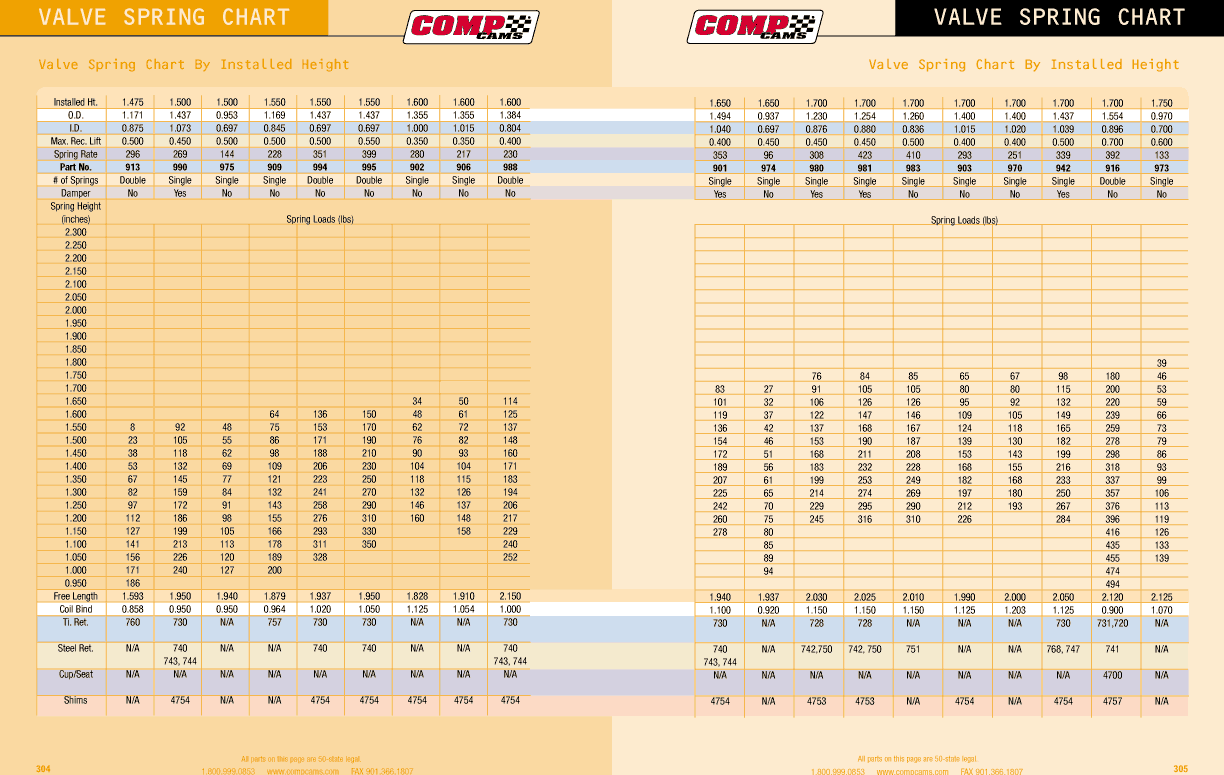

Now heres the new question. There are 2 different springs recommended for the cam that I have, how do I determine which to use? Ill attach the spring table from comp cams, the springs are the 981 and the 983. They look like they are almost the same?

The 983 doesn't have a damper, the 981 does. The 981 would be the preferred one.
