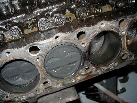

I am currently rebuilding an '86 z28 with a 305 with a carb.
It took me and a friend about 18 hours to pull the engine completely from the car, but this is mostly cause we encountered a horrendously seized bellhousing bolt that we eventually had to break. I would say it would have taken us only 10 - 12 hours had we not ran into this problem. However it was not a TPI engine.
A reference source I recommend is Chiltons (of course) and the S-A design book "How to build the Smallblock Chevrolet". This is an excellent book that will lead you step by step through the whole process of rebuilding the engine yourself if you choose to do this.
Someone please correct me on this if I am wrong, but from what I can ascertain the F-body cars built in 1986 had either the 1985-1986 version of the block but many had the 1987 and up block (from what I am told, cars that were built later in the 86 model year). This can make things a bit tricky as far as buying a rebuilt kit goes. However chances are if you have centerbolt valve covers you have the 87 and up version of the 305.
In rebuilding this 305 you have to use a hydraulic cam and chances are your stock lifters are done for which means you'll need a new hydraulic cam and new hydraulic roller lifters which are more expensive than regular cam setups.
A nice way to add some power is to up the compression a bit, stock it was 8.6 on the LG4 5 liter block. Federal Mogul sells a piston for the engine that has 9.6 compression, from what I am told this will net you 10 - 15 hp. I got a set with moly rings for $180 after tax.
Federal Mogul also offers stock crankshafts with a core exchange for $225, I purchased one from my local machine shop.
My rebuild isn't currently done, but using the book, thus far it has been rather straight forward and while it hasn't been easy its hasn't been overtly difficult.

pyrrano: If you are doing a more mild rebuild I would recommend the kit, however, personally I didn't really like the cam PAW was offering, but the kit does save cost.
robertg: I stand corrected, they did have 9.5 compression. However I would say that by comparison the stock pistons look to be dished somewhat (a small amount) and not totally flat by comparison to aftermarket flat top pistons. ::shrug::
