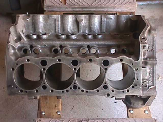

Here is a picture of siamese 400's. Like said earlier if you drill the steam hole in the heads you will not have a problem. plus this little bugger can make plent of easy horsepower, with limited stress on the engine. I have one that im in the process of building and plan on getting close to 500 hp/tq.
