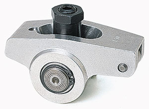

The Crane Blazer roller rockers work very well.
If you want a alumium roller rocker that will outlive you,
get a set of Scorpion Rockers. If you want to get high ratio rockers just be sure that your valve springs can handle the higher lift. You can't use self aligning rockers with pushrod guide plates. It's one or the other. not both.
Here's some beauti rockers you can checkout
http://www.enginekits.com/specials/specials1.html
Here are the Crane Blue Racer "Blazer" roller rocker
http://www.blueracer.cranecams.com/chevysb.htm
PN# WG-3060 3/8 stud 1.5:1
Not the same beast as the Crane Energizer rocker.
Old Dec 28, 2002 | 07:14 PM
F-BIRD'88's Avatar
Joined: Sep 2001
Posts: 6,111
Likes: 53
From: Ontario, Canada
Car: 1988 Firebird S/E
Engine: 406Ci Vortec SBC
