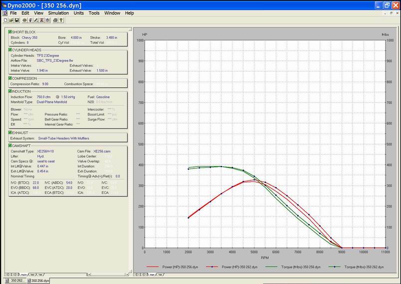

I know not everyone likes to use DD2000 but it is pretty accurate with a 350 and common parts. At least for charting trends in performance
Here is a comparison of the two cams on identical engines. Nothing much to write home about for the XE 262 over the 256, is there?

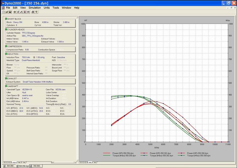

Here are the latter two compared against the XE 268.
As we can see, the XE256 holds its own very nicely up to about 4500 rpm, with a definite lower rpm advantage. Then the other two take over.

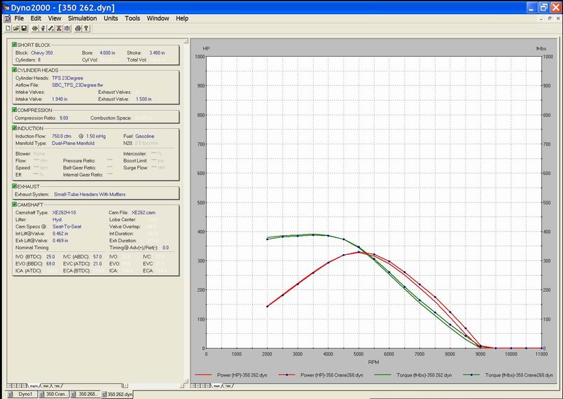

Just for chuckles I compared the Comp XE 262 to the Crane PowerMax 260 on identical engines. Quite a difference a 2 step milder grind like the PM 260 can make due to optimised valve opening points, eh?
I always get a nice warm feeling when I see the cam I use (the Crane 260) stacked up against the competition. The PM 260 is one terrific but often overlooked grind
