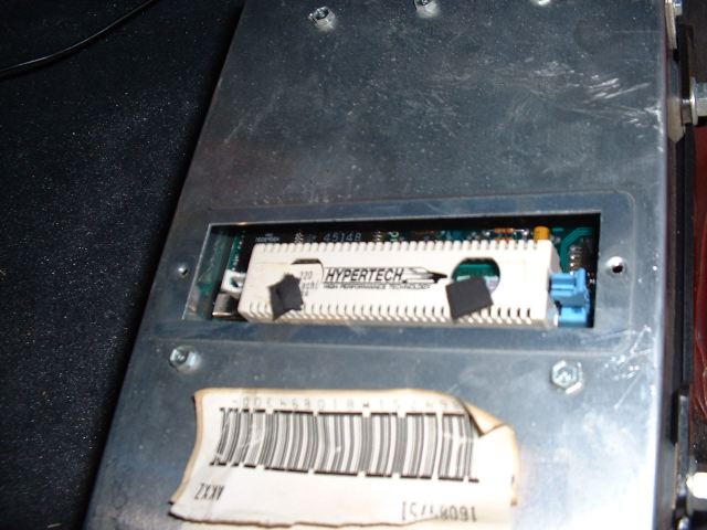

oh and one more thing. i found this tonight. its getting replaced tomorrow with stock that a friend is burning for me. think it can have any impact?

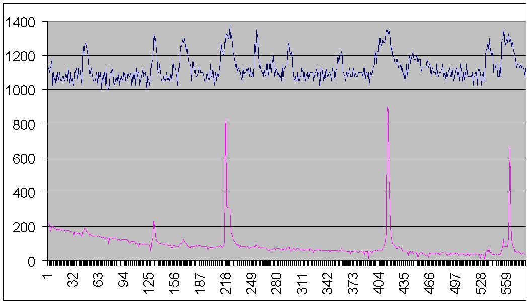

sprayed some starting fluid near the injectors and lower plenum area where the runners bolt to the base. (tried to concentrate most of the spray on the injectors where they go into the base)
and as you can see i do have a slight leak. well i guess its slight, i don't really know how bad of a leak it is. but since i have around 18" of vaccum it can't be too bad can it? this graph shows the RMPs rise when i sprayed the starting fluid near the injectors on both sides and trying some other areas along with the O2 mV. the whole graph takes place over about 7 and a half minutes. i wonder how bad of a leak i do have...
oh and this was all done with the IAC unplugged
EDIT: ok now i am as confused as a Mexican in a Chinese McDonalds.. the BLM's throughout this graph were at 128 in Cell 1 the WHOLE time EXCEPT when i sprayed the starter fluid. when i sprayed the starting fluid the BLM cell would goto 2 and the BLMS went to 126.. other then that they stayed at 128 and didn't move at all.. i don't see how i could be running at 128 unless maybe it had somethign to do with the IAC not being connected and it was screwing things up? it said i was in closed loop
EDIT2: hmm i just noticed something else VERY interesting... my usual closed throttle TPS voltage is .71 (i adjusted minumum air and had opened the throttle some and forgot to change the TPS voltage). but when i did the vaccum leak test i had unplugged the IAC but it didn't close all the way (yes i did the correct procedure to close the IAC) so i had to back the throttle adjustment screw out all the way and the idle wouldn't go below 1000 but the voltage was .57 instead of .71.. maybe that had something to do with it...

The base tps reading relies on the IAC adjustment, that's why you adjust the IAC before doing the TPS. If you moved the minimum air position and the TPS voltage changed, that's normal.
Did you install the o-rings for your fuel injectors dry?
Old Feb 11, 2003 | 04:03 AM
Z_Ghost's Avatar
Joined: Sep 2000
Posts: 595
From: Arlington Texas
Next time try cutting the pic down some, it's hard to read when I have to scroll right and left all the time.
OK it is easier to read when I am replying.
So did you put them in dry?
You should not get any reaction at all, that says that you have a vacuum leak, even a small one can cause problems.
You do need to clean and replace that IAC, fix that and the vacuum leak.
The IAC is a vacuum leak, the computer know how far it wants it opened or closed and calculates that air getting into the motor, if it's not going were the computer tells it to then that throws things off.
Get them fixed and we can see how it runs after that.

i think i might have, i know that i added oil to the upper o-rings but but it started to rain when i was working on getting them into the base so i don't think i did. and i didn't think anything of it until after i had the plenum bolted on for the last time and i hoped that they came with enough oil from Cruzin Performance that it wouldn't effect it. but i guess maybe that is not the case. well it looks like i will doing that this weekend. do u have to pull ur runners to get the fuel rail off? oh well they need to be polished better anyways..
ya but still at least that air is metered through the MAF though right? i was gonna take it off today in School to clean it, but we had ANOTHER day of cleaning the shop. i might try to get to it later today.
