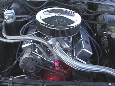

Heres one of the whole engine:
Old Feb 19, 2003 | 11:08 PM
Squeeks83's Avatar
Posts: 973
From: Avondale, AZ, used to be seattle, washington
Car: 1978 Chevrolet C10
Transmission: Turbo 350
now thats one ****ing clean looking engine bay. tomarrow im about to go out and drain the A/C system of the freon, dont tall no one... , then im taking it all off, and just cap it till i can go buy a A/C heater box from a friend for $40.

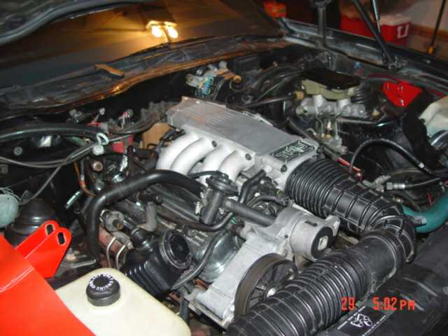

im a little confused about what all you guys did. i dont know the names of the parts that you guys are talking about very well. Please help me, what could i do to get the clean look of your bays.

ooh...ooh, i want mine to look that good to. what besides the A/c did you guys do to get it looking so good?

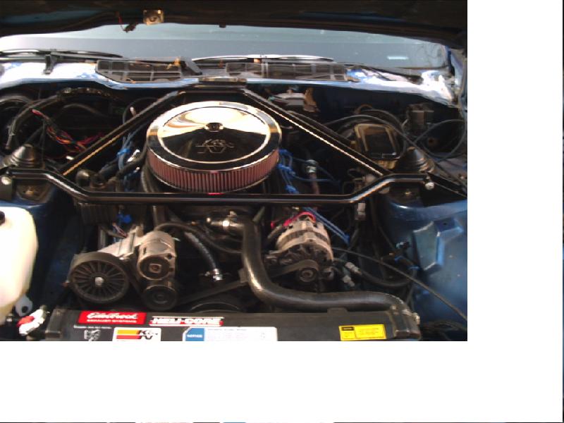

might want a pic huh

vjo90RS8, what Strut tower brace is that you have?
Old Feb 22, 2003 | 12:32 PM
vjo90RS8's Avatar
Posts: 1,828
From: San Jose, CA
Car: 2002 Z28
Edelbrock TBI/ Carb STB , pretty easy installation, and it really tighted up the front end , about $120 i believe from summit.
