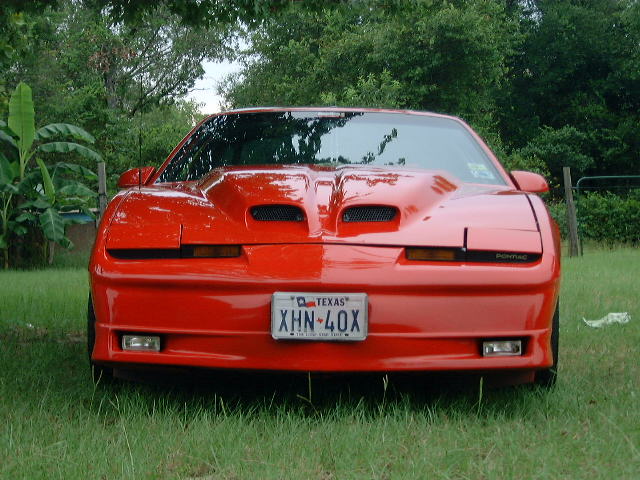

What do you guys think ab out ths setup, and none of that swap your 305 for a 350 stuff im keeping my 305.. I have a 1988 T/A 305TPI with 700R4 and 323 posi.. Mods as of now are listed below.. I am rebuilding the engine but also making it a 335 stroker, adding 52mm throttle body, ported polished and simeased plenum, simeased slp large tube runners, 22lb injectors, accel super ram intake manifold, sportsman II heads(64cc), some kind of good cam to match the rest of the setup not sure what duration or anything yet, adjustable fuel pressure regulator, better fuel pump. Also rebuilding tranny and adding a good shift kit. Already have a good exaust setup for this, but will probrably have to have a chip specially burned for me.. This should yield some good power from a 305TPI.. So what doesn everyone think... thanks..
