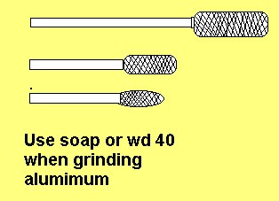

Basicly I do the whole job with just three cutters.
A few stones, and a rat tail file in a drill.
Then I polish the exhaust ports and chambers with some rolls.
Need one long 6" shaft cutter. Get the double cut style for cast iron.
