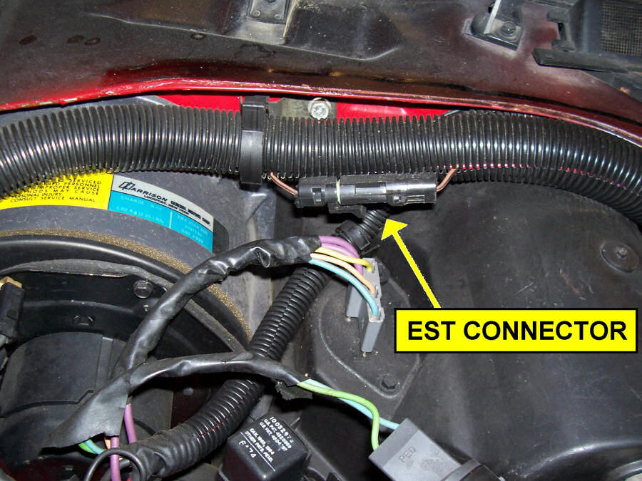

Disconnect the EST bypass connector and see if the situation improves.

Ok thx. Is this EST bypass connector labeled somewhere ? I don't know what one is ?

The EST bypass connector is in the engine compartment, along the firewall. It is a single wire connector in a tan/black wire that should be near the HVAC blower motor:

Hey Vader I tried disconnecting the connection as per your pic. The car did not want to run it sputtered, then died. I'd start it again and then it would die didn't get more than 10 feet. Once I put it back together the car ran but now shows a code 42 and code 43. I guess the 42 is to be expected. So I cleared the codes and the 43 shows up again after about 10 minutes driving.
