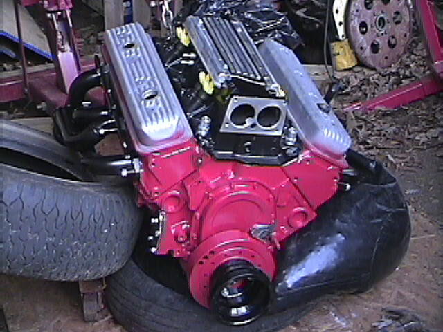

hey guys im not sure if im doing something wrong here, but i tried to put on my lt1 intake today and the bolt holes line up with the head holes, but i cant get the bolts to start, and allso, some of the middle holes is allmost inpossible to get a wrench on, im using just standerd hex chevy intake bolts, do i need to go with my tpi bolts, if so i need to reorder them , lost them in the shuffle of parts, allso if reuse the tpi intake bolts will they sit at a angle like these bolts did, if so im not to crazy about that ideal, ,
Attached Thumbnails help with lt1 intake bolts, tpi motor-3f03-3-29-17

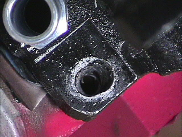

bolts im using
Attached Thumbnails help with lt1 intake bolts, tpi motor-4f03-3-29-17
Old Mar 29, 2003 | 07:42 PM
FIREBIRD7777's Avatar
Posts: 291
intake holes are lineing up with the head holes, no gasket is in the way
Attached Thumbnails help with lt1 intake bolts, tpi motor-5f03-3-29-17

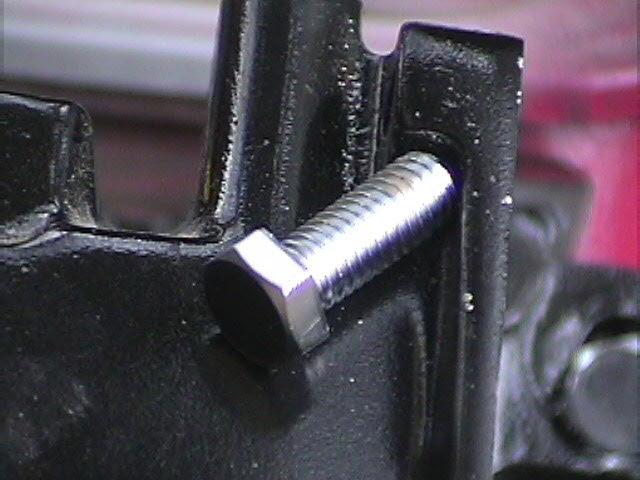

i got one bolt started,( no i didnt cross thread) but it sits in a angle like so, will the oem tpi bolts do the same ?
Attached Thumbnails help with lt1 intake bolts, tpi motor-6f03-3-29-17

You must have older heads...
I don't think a different bolt is going to move the bolt hole. I could be wrong though.
The newer heads (87-up) have the center 2 intake bolt holes at a different angle. Looks like you have a 87-up intake and 86-back heads.
You can elongate the holes like you did, but you need either some self-centering ball-type spacers, or some slanted spacers cut at 18°.

The LT1 intake conversion requires the four corner bolt holes to be re-angled so the bolt will line up with the heads. There is no way around this. Ordering new bolts will not change the angle.
Stick with the Allen head intake bolts and use washers under each one. You will be fine.
Now, for the one that doesn't start. You should have test fit before sealing the intake down. The intake will have to be removed and the bolt hole filed for a perfect fit.

You cannot use the TPI intake bolts. The thread is just fine but the head of the bolt is HUGE. It could interfer with the intake on the center bolts. This will depend on if you have early or late style heads.
Your bolt that will not thread in but the stock bolt will tells you that it's the WRONG thread. Probably metric.
You need 3/8" x 18 x 1 1/4" bolts, not metric.
