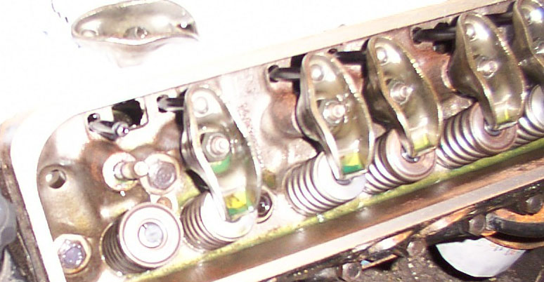

the heads are 14096217 castings. the have the "canted"4 center bolts(87+ centerbolt VC). here's a pic. what type are they guys? i'm not even a head novice.

anyone? i guess these have the slots and do not require SA rockers right?

You are correct. Those are indeed the narrow slots. Your only correct rocker option is old-style rockers, with no guide plates.
