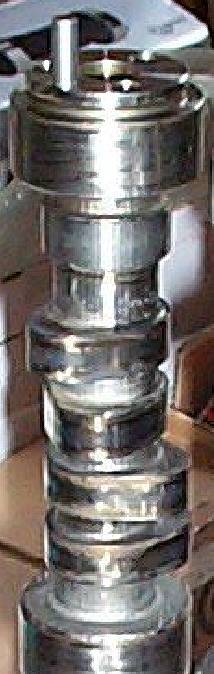

Are the cast iron cams completely machined, including the spaces between the lobes? The only cam I have ever seen like this was a Mercury Marine unit out of a outdrived 305- sold it to a gentleman in Maryland who was VERY happy with it...

If you look closely at any later factory camshaft, you'll see a series of about 90 indexed cuts around the circumference. This is done to pre-form the blank and reduce time on the grinder. NC milling is a lot faster than grinding, and it's all about throughput.

That is an answer. I would have done it differently, but I do not know all the parameters that need to be satified..
