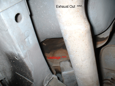

This is that stain I was talking about...
A picture from beneath my car. Notice the black "stream" comming from the gas tank (at least I think it is). Might this be where the pressure bleed-off is going? (a long-shot, I know )

Your apparent leakage near the tank could be from several sources. In order to determine if the pressure drop is injector leakage, you can try applying about 1/3 throttle when cranking the engine when it is warm. This will admit extra air, and should not cause additional flooding. Some earler, less sophisticated EFI systems would apply fuel whenever the engine was turning and would base the fuel rate on the throttle position. You car won't do that while cranking, so there is no fear of causing problems by applying some throttle while starting to help clear a flooded condition. As a matter of fact, any throttle opening over 80% will completely cut off all fuel delivery while cranking, in a "Clear Flood" mode that was programmed specifically for that purpose.
