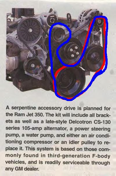

This just came to my head.
Attached Thumbnails A/C delete: Do you need the pulley?-serp-setup.jpg

transam12sec.....that is the exact way im running my belt now. i cut off all the other part of the tensioner acc bracket and am running it exactly as you have drawn. that way it wont hit the upper rad hose. but i have to either get a longer belt or put my smaller underdrive crank pulley on there to see if the belt i have now will be long enough.
but i want to get rid of the pass side bracket and tensioner altogether......will the first belt routing give me enough contact area on the waterpump??? (just like afathippo ran his)
