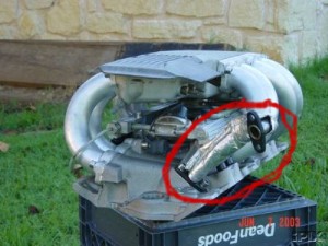

whats this hose for??said it had a corvette intake what the diff

That hose is the exhaust gas supply to the EGR valve. F-body TPI intakes don't have that, they use the exhaust crossover passages in the heads instead, but the Vette heads don't have that passage so they use the tube.
