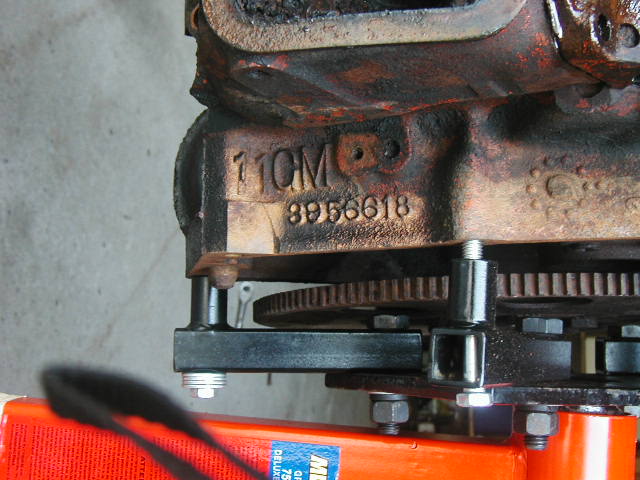

I have this old junker engine and I would like to run the codes before I go insane trying to dissassemble the rusted clunker. Has anyone done this before? I got the ones from the end of the block, where the flywheel is.

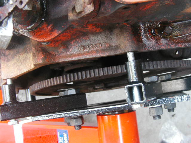

From that one I cant tell if it is a G or a C for the first letter. Hmmm. I dont know the signifigance of them; at first I glazed over them thinking well duh! Gm made the block. Then I tried to run this code on the other side:
Joined: Nov 2002
Posts: 204
From: Apparently somewhere breeding stupidity.
Which one of these are signifigant? What do they mean?

3956618....302.....69....4...Z-28 Camaro
from www.mortec.com
You just hit the jackpot buddy!!!
Don't touch that motor. Do not disturb ANYTHING WHATSOEVER about it. Put it in Hemmings Motor News, it is worth several times what it will take you to build a real nice 350.
from www.mortec.com
according to "www.mortec.com" it could be one of three different motors, you will have to measure the stroke to find out which.
it's either a:
69---302 which is 4.00 bore x 3.00 stroke
68-69---327 which is 4.00 bore x 3.25 stroke
69 ---- 350 which is 4.00 bore x 3.48 stroke
as you can see the only difference is in the stroke of the crank, you could flip it over and pull the pan, then find the casting numbers on the crank, they should tell you which one it is.
of course, if the block is in good shape you can always get a aftermarket crank and build a nice 383 out of it.

I got excited and forgot to post a couple of things after all that....
Do pull the oil pan and see how many bolts are on the mains. I notice that it has a flex plate on it, which is impossible for a 69 Z28 302 in OE condition; so it might or might not still be a 302, or might have been one of the other 69 4.000" bore motors.
If it's a 302, in OE trim, it will have solid lifters; double-hump heads; and domed pistons. The crank will be steel. If all fo these conditions are met, it's the motor I referred to. If any of them are not, then either it's been altered, or it was one of the other motors.

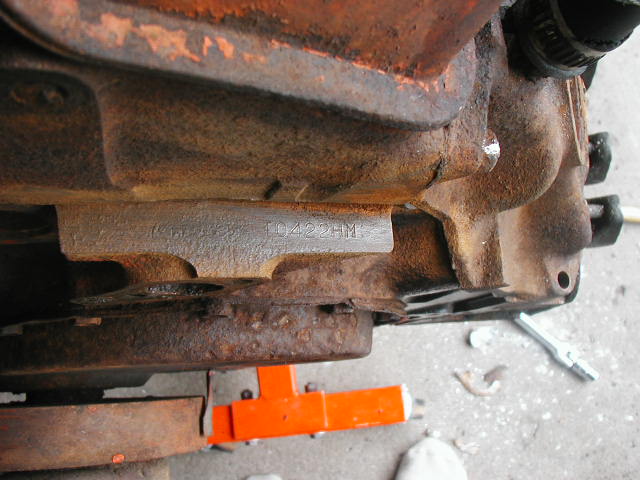

look in front of the passanger side head on the little ledge to the left of the water pump... what do the numbers there say? should have a partial vin from the origional vehicle it came from along with a date code and a suffix code all of which would be helpful in identifying what it is that you have.
Joined: Nov 2002
Posts: 204
It appears that the stamping is T0422HM if the pic isnt clear. This is on the deck surface of the passenger side head. There are some mubers to the side of that that are not really visible in the pic, and I'll have go after it with sandpaper to make them visible enough. I'll get back if those are needed, but I think these are the ones you are after.

T0422HM
Tonawanda, April22
1965 HM 327 a/c, trans ign, m/t 365 4 Vette/Chevy II
1968 HM 327 tur hydramatic 250 4 full size
1969 HM 350 a/t 250 2 full size/Chevy II
http://www.nastyz28.com/sbchevy/spcode5.html
Tonawanda, April22

Ya it would make alot of sense that it came with a '69 full size. In that case I hope it isnt to hammered like alot of those would be. Thanks guys! At least I know that it is worth tearing down and Magnafluxing.
Joined: Apr 2002
Posts: 3,552
From: New Jersey
Car: 86 Corvette, 89 IROC, 1999 TA
Engine: 350, 350, LS1
Transmission: 700r4, 700r4, T-56
Axle/Gears: 3.07, 373, 4.10
and theres your answer.. it has 2 bolts mains 1969 HM 350 a/t 250 2 full size/Chevy II.. still a good block to start with IMO, good metal content and should be done with core shift by now.. might not be the gold mine a stock 302 woulda been but a good block to build up none the less.. what heads does it have on it?
