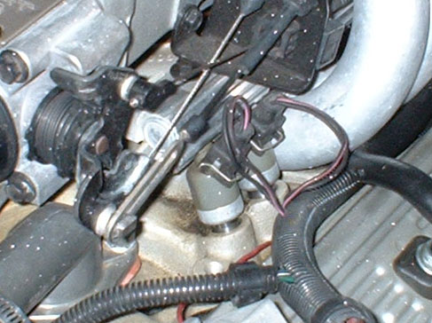

I've posted a picture of my #1 and #3 injectors on my L98 engine. Notice the black area on the intake manifolds and the outer casing (green part) of the #1 injector (hard to see).
I'm just wondering because my gas mileage has been horrible lately, and I have reason to believe the fuel system is loosing pressure quicker than it should (fuel pressure test).
Does this look like fuel leakage?

Could be. That's similar to what mine looked like after one of my Accels cracked.
How fast is the pressure dropping?
I actually had a puddle of gas sitting on my manifold.

Your fuel pressure loss rate looks fairly normal. A leaking injector would probably drop pressure much faster, and any injector leaking enough to affect mixture would drop pressure MUCH faster. Most likely you have a valve in the fuel pump seeping, or a slight leak at the disc/seat of the FPR, niether of which are an issue with that rate of loss.
None of that, of course, means that your injctors are flowing at the correct rate, but serious internal leakage is not likely an issue. The dark area around the bottoms of the injectors does look more like 'O' ring leakage. A new set of injector 'O' rings is usually about $23, and if you replace those, it would be a good time to do something with your injectors. I have also heard from Rich that servicing the earlier-style Multec injectors is seldom worth the effort. Perhaps you could find a set of take-outs on eBay or some other source, have them cleaned, flow matched, and ready to install when you undertake the project. The nice thing about that (other than peace of mind) is that you'll get good 'O' rings back with the injectors.
