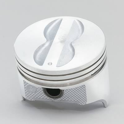

Maro: I didn't degree my cam. Some people think it's a HUGE NO NO to have installed the cam straight up like you and I do, even though many many many many people do. Comp Cams told me to install mine straight up. IT's built with 4deg advance in it. If the cam was like some generic brand, then I might degree it, but Comp is good stuff.
Your head gasket can't be .45 thick, it has to be .045.
If you did not Zero Deck your block, meaning that a machinist milled the deck (top part of the block where the pistons come up to) to make the deck even with the top of the piston, the .045 gasket is pretty bad.
If you have dish pistons it's not as bad.
Stock head gaskets are .015 thick steel shims, and deck height (piston top to deck top) is .025.
Deck height Plus gasket thickness = Quench
For Best performance and least posability of knock/ping/pre ignition Quench needs to be between .035 and .045 .040 being optimum.
If you still have stock deck height of .025... and put a .045 gasket on it your quench is .07! thats huge. This means that alot of your A/F mixture is not getting completely into the combustion chamber which is only 3/4 of the cylinder bore, and stuffed under the head on the flat spot.
Fel-1094 are .015 steel shim gasket that many people use and have great luck with. 19.95 ea ($40 for the set not 80-100) You need to buy a can of Copper Coat from napa or an autoparts store.
Bet that helps your running problem too. Atleast you'll ping less, have higher compression for more power, and have more power from optimum quench.
Hope that came out clear enough for ya!
BTW I gap my plugs at .045 with MSD Box and Coil. Stock ignition do NOT gap bigger than spec.

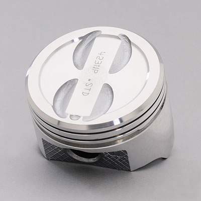

Yep, get the gaskets, spray copper coat on one front to back both sides (I held it in mid air with a screw driver) let it get tacky for about 3 minutes, then put it on the block, the the head.
I can tell you I did the same thing. Rebuilt the motor with a rebuild kit didn't know anything about Quench. I can tell you that my spark plugs looked like aliens. The porcelan was buldging, I was getting quite a bit of knock.
You have dish pistons however, and I've read that Quench is not THAT big of a deal, because no matter how close you get that tip of the piston dish to the head, you still have that dish that makes the quench bigger.
if your piston has a dish like this: I wouldn't worry about it: DISHED
If it looks like this: I might think about changing it: FLAT TOP

lol you know whats sad, i dont remember if they were flat top or not....whatever they are, they are the Stock pistons. i dont think the L03 came with flat top pistons seeing how flat top is better , i think the L03 came with the worst of the worsts.
maybe someone on here can tell me if they are dish or flat top if they are stock.

I believe the L03 came with flat-tops; perhaps someone else who has worked on one can verify.
