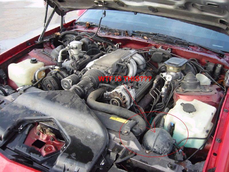

If this is under the hood, and the 2 lines are coming through the firewall right below the heater hose nipples in a harness with the A/C and blower wiring, that would be the line in question.
It should go to the vacuum reservoir, which might be a ball with 2 vacuum connections, or it might be a long narrow half-cylinder kind of thing. One of the connections (the larger one) on the reservoir should go to a nipple on the intake mainfold, and the one from the harness above should go to the smaller one.
This sounds like it!

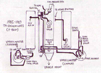

Think I know what you are refering to here. 2 pics I found on the board:

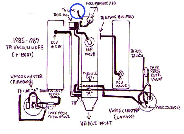

Larger version.
I'll have a look tomorrow and try to plug it in somewhere and see how it is on my way to work.
