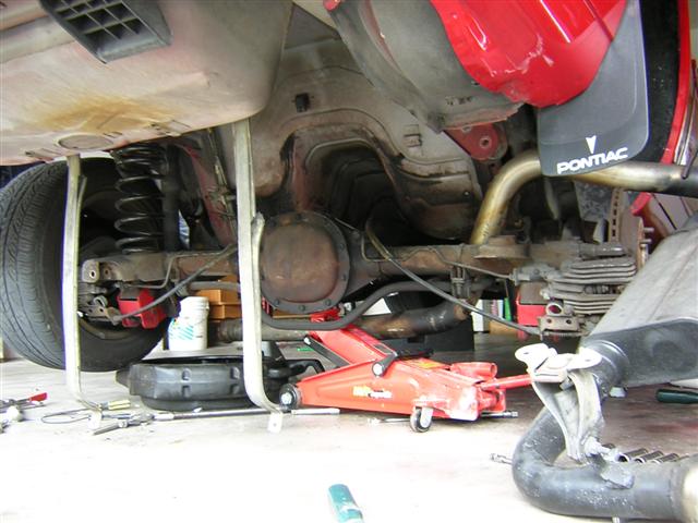

my fuel pump died this afternoon. i have the car on ramps and jackstands but looks like i still dont have enough room to tackle this job. i may end up bringing it to a garage. anyways my q's are:
the car is about 3 feet off the ground. i stuck in a small hose thru the filler neck. only about 2 gallons came out. any other better ways to get the fuel out? (of course the tank just happens to be about 3/4 full)
also i noticed what looks like a fuel leak coming from the corner of the tank. is it safe to say i need a new tank? i attatched some pics. also notice it seems to be leaking on to my exhaust tip. the stain isn't wet but it's kinda damp. sorta like a dry oil leak.

ok......
emtying the tank isn't a problem anymore, i ran power straight from the battery and it moved the pump, so now it's working. i can use it to quickly empty the gas outta there.
still wondering about that stain
new problem. my exhaust is one piece from the cat to the muffler. is it possible to remove the tank by disconnecting the exhaust at the cat and moving it around, or will i have to cut it somewhere?

ok tank is out. wasn't too bad of a job. just a lot of **** to remove. no need to remove torque arm or driveshaft or cut my exhaust.
i uploaded a new pic showing where the gas is leaking from. i know it's probably fixable but i'd much rather get a new tank. where would be the best place to get one? so far no info with a search.

how would the sending unit not make the car start? i checked for power and ground at the connector at the tank. everything checked out ok.
the crack isn't too big, so i'd rather fix it than spend money on a new one. is there anything i can put on the crack to seal it that will hold? or am i better off having it welded? i dont wanna take it down again soon if the leak doesn't stop.
Edit: decided to just JB Weld it since it's not really a big crack. hopefully i'll be done with the whole job tonight.

I got my 83 z28 at a junk yard. It had a bad pump and was sitting for years. After I got the tank out i noticed that it had many leaks. The inside was a rust nightmare. I got a tank out of an 86 camaro for 20 bucks at another junk yard. they even got it out for me. It fit like OJ's glove. perfect. only had to change a few little wires. All third gen gas tanks are interchangeable. It was much cheaper than getting one through the mail. So i would suggest getting one at a junk yard and saving about 180 bucks.

well i finished the job finally. hopefully the jb weld will hold for a while. my tank actually looked brand new after i cleaned it, except for the small crack.
