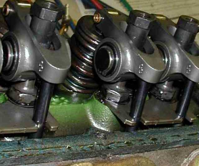

What heads are you using, what are your goals for the motor, and what kind of budget do you have?
Self-aligning rockers are needed if your heads have the large holes around the push rods, but no guide plates. If your heads have either the narrow slots that fit tight to the push rods, or guide plates, DO NOT use self-aligners.
Don't try to skimp on valve springs. Roller cams have very fast valve action, and benefit from stronger springs than just the raw lift numbers would seem to require. If the cam you pick is anywhere near the limits of the recommended spring, consider stepping up to the next spring. It's alot cheaper to do it now than it is to deal with the problems (parts breakage) that inadequate springs will cause over the long term.
Beyond that, there's not much else to it. Personally I avoid aluminum rockers for street use, because they tend fail suddenly and unexpectedly after not a whole lot of miles; I prefer the Comp steel ones.I use an adjustable push rod to find the optimum rocker geometry after the whole rest of the motor is built, and then buy the push rods that fit the best; there's no way to predict with certainty what length push rods you might need, once things start getting modified from stock.

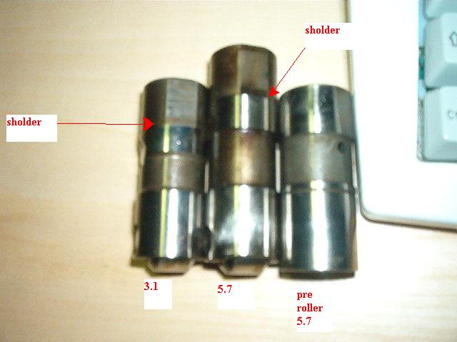

or you could turn an older block (400) like I did into a roller block using off the shelf parts 3.1l roller lifters, stock 87-up 305-350 lifter retainers and spiderplate. cam button or like I did offset the factory retainer to the front of the block. also need shorter than stock flat hyd. pushrods (7.5XX" with oil hole!) found on 95? 5.8l f150 fords (ELGIN Industries part # PR-446S) they cost around $30.00, beats the compucam price $150.00 or more not even hardened same length
I guess I really would not recomend doing this but, I had everthing but the push rods so the choice was worth doing for me.

I did the convertion to mine when I first got the 400 sbc, then after a year or so people where telling me that this guy on e-bay was selling plans on how to do it? well it just gets me how people will sell something like that it works for me but, what if you blow up your motor with plans I sold? see my point ? at least I told you not to and didn't try and make a quick buck. pluse its requires grinding to the sides of the lifter retainers till they fit flat on the block.

here is a picture for you guys who have been asking. this shows how the stock 5.7 roller lifter is too tall for a nonroller block. the sholder is almost the same height as the top of a reg. lifter so the retainer would lift up off the block as soon as you got and valve lift at all. the sholder on the 3.1 lifter never reaches the top of the bore.

I ordered a 3.1 L roller lifter from SDPC, just to see if it looked like the one shown in the pic, and the part I recieved was the 5.7 lifter. I was bummed !
So the whole operation seems almost self explanatory, but I'd love to get a part # for the 3.1 lifters.

I wanted to add my .02 cents as far as aluminum rockers go. I was using a set of Mr. Gasket 1.5 that were used out of a circle track motor that where slightly ground on to accomidate large springs. So we all know how much abuse just a few seasons would do. They worked perfectly, other than the fact I had my head up my ***, and didnt run any guide plates. My reasoning at the time was if I keep them tight, they should stay lined up. I took the valve covers off at some point to adjust them, when I notice that half of them had turned slightly and were not sitting on the roller end. They were using the end, or head of the rocker to open the valve instead of the roller tip. The lord only knows how long it was doing that. And those alu. rockers didnt break.......

Originally posted by bnoon
I've been searching for the correct 3.1 roller lifters too. What year were the ones you ordered from Scoggin?
In hindsight, if I had this whole 3.1 roller lifter process to go through again, I'd choose to give the dude on ebay his $20 and let him supply me with the part #s and sources.
With SDPC, I called them up and asked for a roller lifter for a 3.1, not knowing that they didn't use rollers til 95. I got a roller lifter but it was for a 5.7 ...not the same. And it cost over $20 incl shipping.
I ended up doing an ebay search for lifters and found a guy in Tenn. named Wiley Hutcherson who sells em. I bid on a set of 12, and when I contacted him, he told me that the thing to do is to order 2 sets of 8 for a 2.2L, it's the same part I guess.
I still don't know what the GM part# is but when/if i get these parts I ordered, I'll post if they look right. I sent a check to the guy last fri.
If this doesn't work let's pitch in and order the instructions from the ebay guy.
Later
