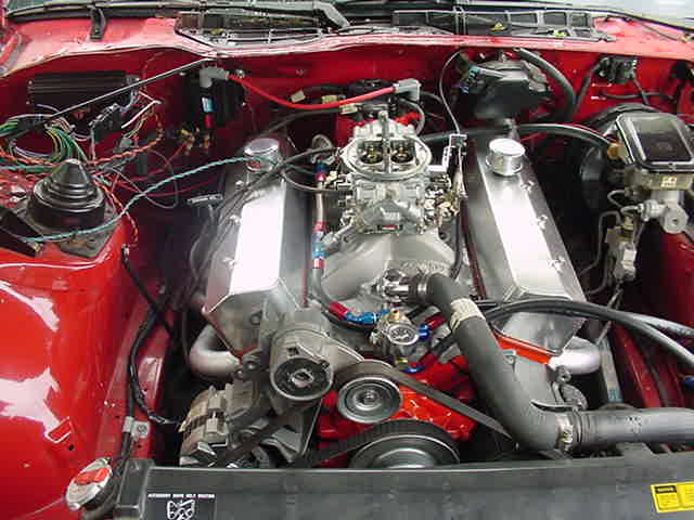

I too thought it was best to keep the coil as close to the dist. as possible. Here is where I put mine. So far, so good. I do still have problems with coil interference with the mag pickup wires.

I want those valve covers!!! Can I buy them somewhere or am I going to have to steal yours? I've never seen any center bolts like that!

I bought those off of eBay for $115 with the breathers. Scoggin Dickey has them at $185 w/o breathers. They do really set off the engine. I really like them.
