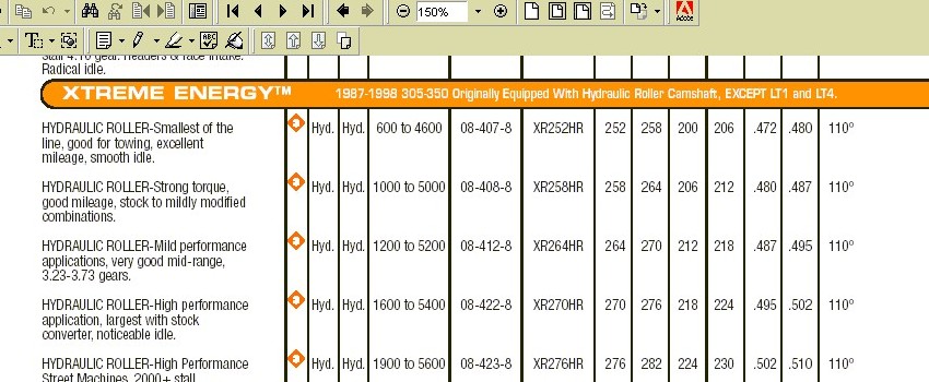

Old Nov 14, 2003 | 06:51 PM
OMINOUS_87's Avatar
Joined: Aug 2002
Posts: 1,824
From: Mesa, AZ: Transplanted from Chicago, IL
specs

Transmission: 4l60e
$$$$$$ for that cam. 345$. It better be a killer cam. Im not sure what Ill do for a cam yet but im pretty set on the etec 170s/
The cam is 240$, that is the going rate for most all of CCs hydra-rollers.
Where did you get 345$ from?
http://store.summitracing.com/partde...2D08%2D423%2D8

What do you consider cheap? I paid 680$ for my Vigilante, I know that aint cheap but I really never researched any others. However Midwest seems to jump out for some reason, you may want to do a search for them.
That looks like a good cam for what I am doing. I may go with that.
Yeah I like that cam alot, so far I havent shifted it past 5000rpm but it pulls like a motha from 3000rpm-5000rpm I know that it has alot more in it past 5000rpm, soon I will be taking it to 5500rpm. I will let you know.

Id like to try to keep the powerband around 2000-5600. I will shift around that. I don't like having to low-end. I don't hardly have any low-end now. I think some 3.73s gears should solve that problem. I need to get the rear-end and suspension done. And a stall. Then the heads and cam.
Im a poor college student...cheap stall would be in the 300$ range. Id like to have a 9.5'' converter but way to expensive...ill probably end up with a 11'' or 12'' stall.
