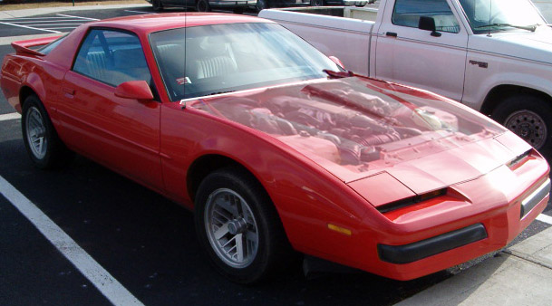

I think I got a good deal, This is what I got for $2500, all I did was have a paint job put on it($900). Save the t56 for later unless you have $$ to burn, which 99% of college students do not. Just dont rush yourself, get EXACTLY what you want, there are many of these cars avaliable. I had to fly from Michigan to NJ to get the exact one I wanted. Then drive it home.
